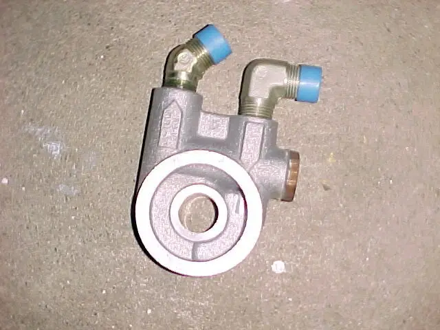

I have a new never been used ford oil cooler i got some years ago from a man who worked at ford product development and engineering. and for the life of me i cant remember what he said it went to (engine wise)! I have some pics hoping someone will recognize it! Here ya go!

looks like it might have come off an svo mustang.

Mid- late- 80s trucks and vans with 460 engines. I think it'll also work on Windsor and Cleveland motors as long as it fits your chasis.

Casting numbers tell everything. Mid 80's truck engine piece.

E5T=1985 Truck

The part in this thread is not an oil cooler.
It is a diverter.
It allows the install of an oil cooler, but is not the cooler itself.

Thanks everybody for the help, also are those sandwich style coolers hard to come by i have a 4 of them. One more thing any body know the value of this? I was told it is a 1993 & 1995 Cobra R block adapter for a oil cooler. I have 4 brand new ones.

The sandwich coolers aren't that scarce. The water/oil versions are used on a lot of cars, including Turbo Coupes and LTD II (Fox chasis) cop cars. If they're new, I'd say they're worth around $50-60. I have around 20 used ones that I can't seem to give away. The one in that last picture is also a cop car part. It's for air/oil cooler setups. Ive seen them in full size LTD cop cars. I have a few of those in used condition also. I sell them for about $25. I really don't think it;s a Cobra "R" part, but I'm not sure. I haven't seen an "R" in so long, I don't remember what the adapter looks like. I'd say a new one of these should be worth around $75. Check PPI (Performance Parts, Inc) to get a better idea on the value.

...any body know the value of this? I was told it is a 1993 & 1995 Cobra R block adapter for a oil cooler. I have 4 brand new ones.
What is the part number?
Look around at someplace like Summit and see what the oil diverters for coolers go for. That will give you a general idea, although it will be retail price. You will rarely get retail value for something in a private sale.
If it is a part that is specific for a low production vehicle, it could have more value. But you have to find just the right buyer... And with so few cars sold, most will have the part still on it.
