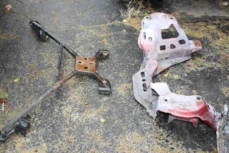

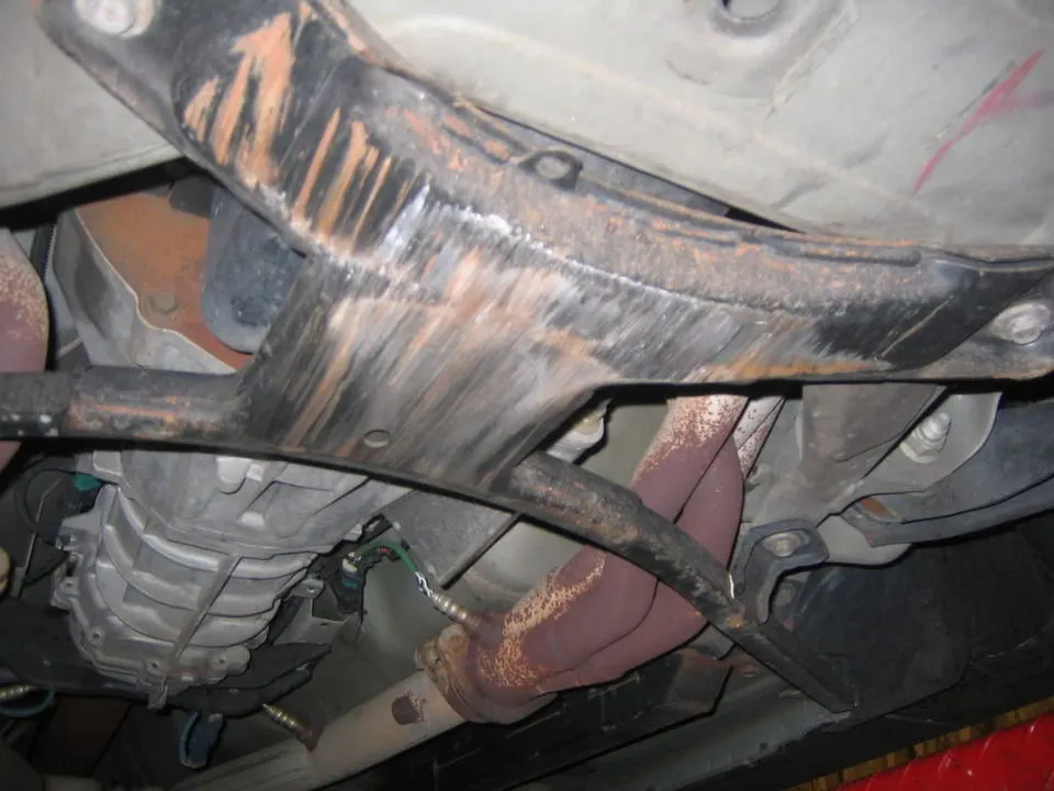

It sits right under the oil drain plug and it sits SOOOO LOW! on a lowered vert. Its scraps everything and almost gets ripped off everyday on ****ty roads i drive on.
What would happen if i remove this thing??
Steeda makes something called a G-trac bar. It stiffens about the same as that, but it's not as low to the ground. I would call them, and see if it would be appropriate.

i still have mine. I'd rather have the brace scrape than my oil pan.
x2. I've thought about taking it off every time I do an oil change, but end up leaving it once I think about what might be impacting if it isn't there.
Saying the pan won't scrape because it's tucked up is accurate as long as what you're scraping on is wide enough to hit the frame rails on both sides. If you're scraping on something 8-12" wide, it could miss those parts that the pan's tucked up between. For instance, I pulled into a gas station the other day and knocked the crap out of mine on one of the manhole covers for filling the in-ground tanks.
I'd love to have mine gone, but am keeping it for the little extra insurance.
Your logic of "my oil pan will scrape if I remove the 'vert X-brace" isn't really solid. Coupes have the pan in the exact same place and we're not scraping our oil pans. As far as what you'd lose if you removed the x-brace, is some chassis rigidity. Coupes make use of the roof structure to reduce body flex; the x-brace attempts to replace that lost structure on 'verts. Since Twista has sub-frame connectors, he may not notice any difference without the brace.

Looking at mine it's different. Ford must have changed the shape/design between the '94's and '95's. Mine clears by about 4" with the FRPP M-5400A suspension. I personally would be inclined to leave it in place. It just works like a skid plate when it makes surface contact.

Early on when I bought my V6 (now the Cobra clone), I bought a chassis brace to install on the car. Never bothered to install it tho. Fast forward several years, I now know it as the 'vert x-brace. It looks exactly like the photo Twista posted, instead of the one Adam posted. Need to junk the thing one of these days, subframes are a better way to go and I avoid steep driveways anyway.
Except that my '94 'vert isn't like the one Twista posted. Mine is the same as Adam95GT's. Ford obviously had two versions. I thought that was the "K" member brace based on it's appearance.
My brace is the same as yours and Adam's.
The brace i posted in the original post is from a 2001 GT vert, but it still hangs low on those cars also. It looks like FORD changed it alittle, but it still hangs low as you can tell from the picture. Same problem.. different year brace.
