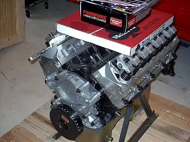

I ran AFR 185's, Holley Systemax Intake, Custom Comp Cam, 70MM TB, Pro-M 80MM Mass Air, 30lb Injectors, 1-3/4" Ceramic Long Tubes w/ 3" Collector, MAC 3" Prochamber, MAC 3" Cat Back. Over do it on your 347 and it will respond with huge numbers. Put 302 stuff on a 347 and you'll get stock numbers.
