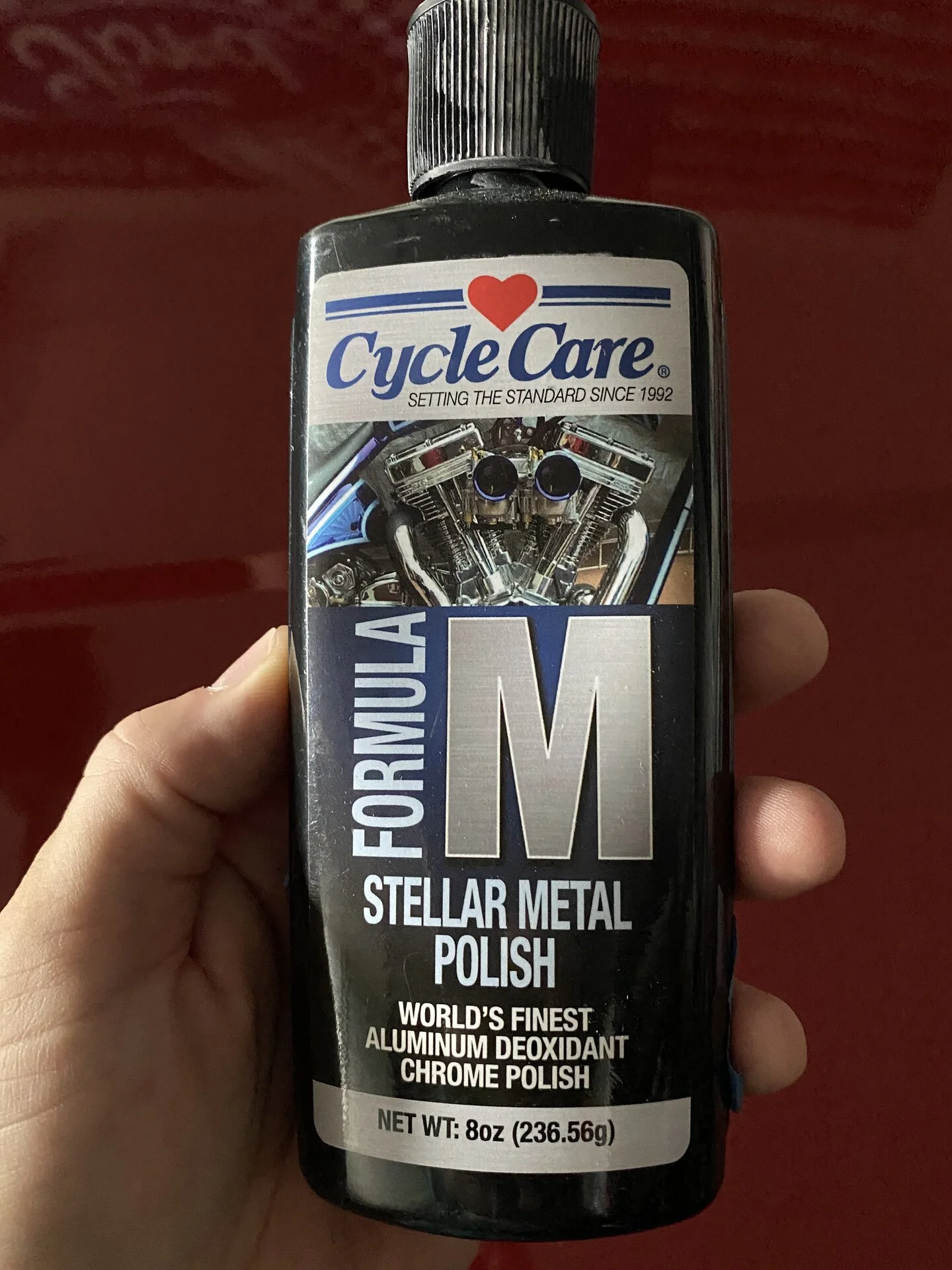

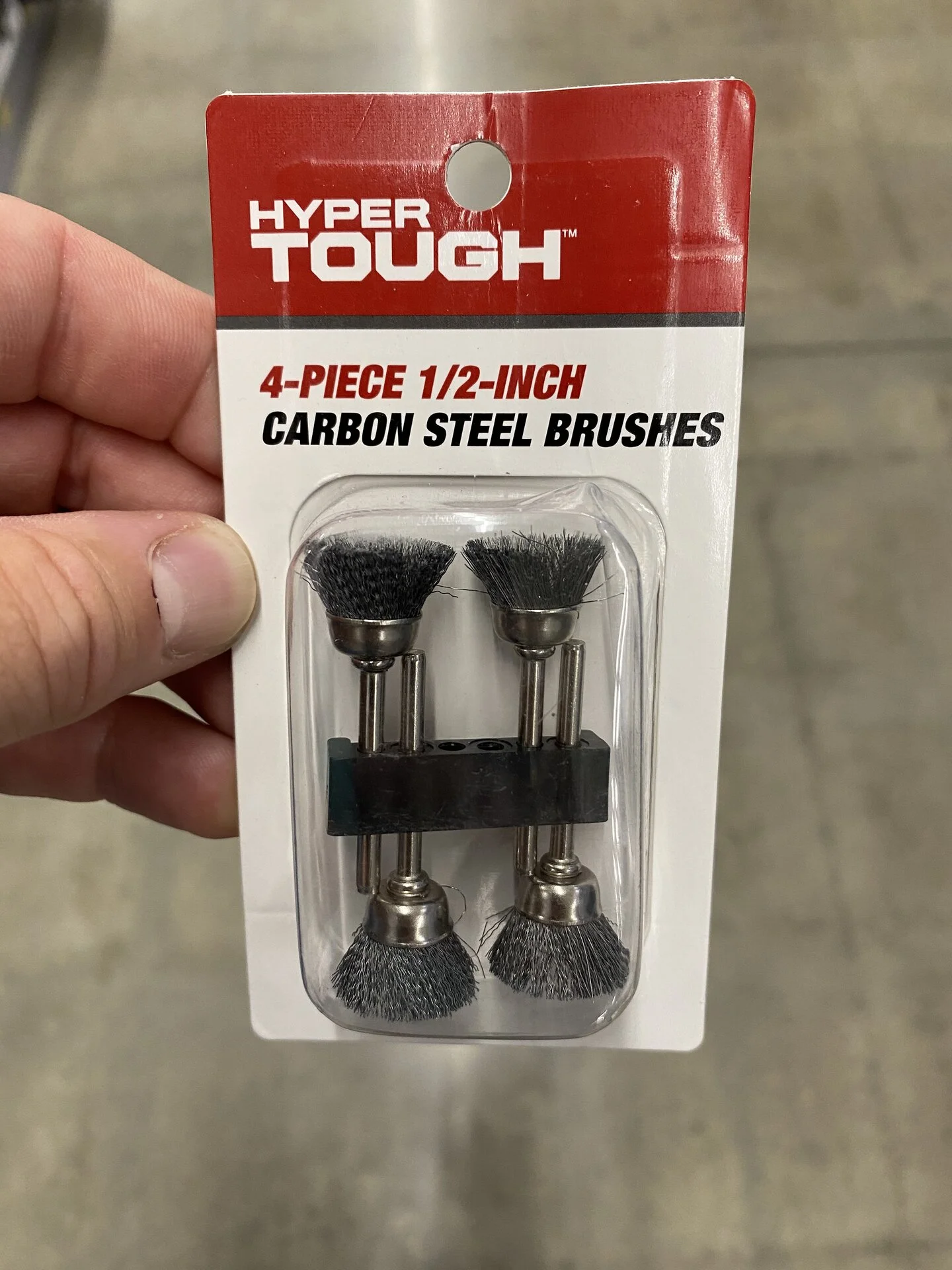

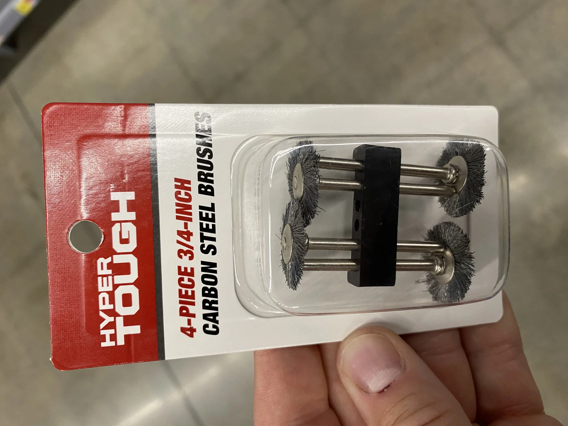

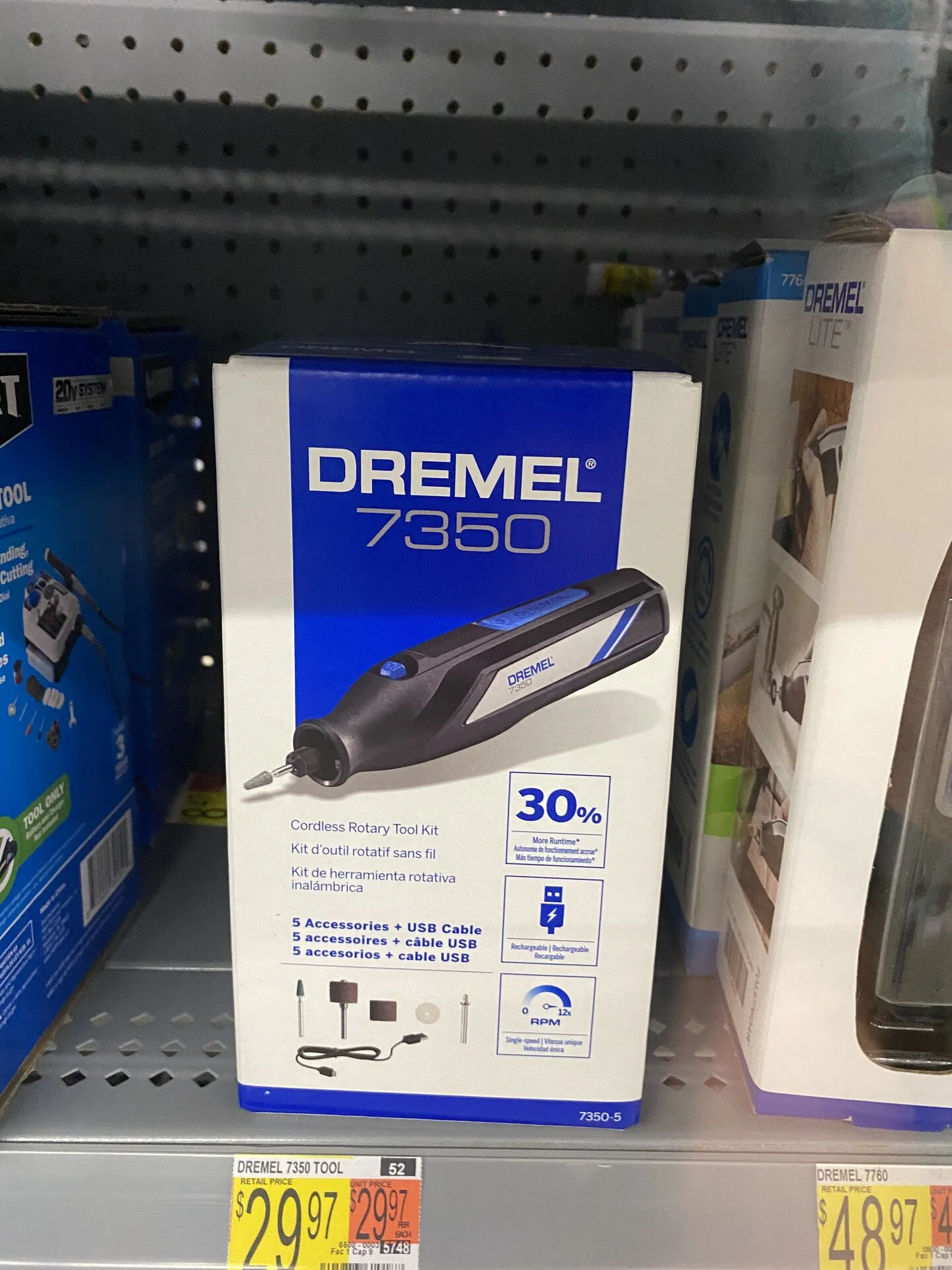

I used a Dremel with the small wire brush attachment and then some polish. Compressor, tensioner and alternator came out shiny and almost new looking. Just go slow and stay away from the compressor seal and tape off the alternator openings to ensure no issues if you choose to try it. Scotch-bright and painting is a nice option also.
Would like to know where you purchased those brushes?? Thanks
