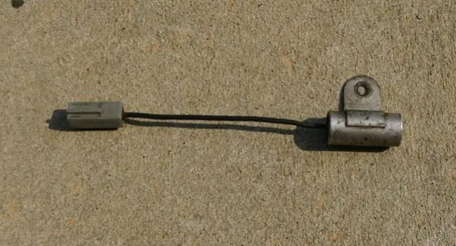

Can someone please identify this
sc mustang
Mar 23, 2009
42
Looks like a condenser but the guy at Autozone said there was no condenser in a 95 electronic ignition system. This was mounted next to the coil. There is one wire going to it only. If you know what it is - can you also tell me where that wire goes and what this device does?

not 100% sure on this, but I think its called a "ballast resistor"....meant to keep the juice going to the coil/ spark plugs at a constant voltage....
, sure someone has a positive answer though...

It's a radio noise suppression capacitor. Ford calls it a "radio ignition interference capacitor".
*DING* *DING* *DING* *DING* *DING*
Give this man a cigar!
:D
If something is wrong with that capacitor, you'll hear engine RPM in your radio as static. Not sure where else it would manifest.
