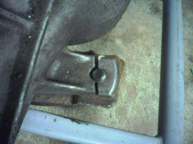

Can this be fixed?? Broken t-5 case PIC
smithjp1
Mar 31, 2005
I have an opportunity to buy a t-5 from a 1989 with all the necessary pieces to convert my AOD minus computer and pedals for $250
But now that I go see it I, I see this sheet
should I just spend my $$ elswhere or but this thing
He was in a head on collion and is now parting the car out
Thanks
Paul
you got a tig welder?
I will warn you welding these things is a pain (I hate welding cast AL)
better make sure he is selling it cheap
the thing I would want to know is how it broke (droped or solid mounts + high power, if its been beaten on it could be on it's last leg)
It can be welded, but I would recommend having an expert do it. I don't think you need a TIG, but a MIG will do the trick. Provided you have the correct wire, etc... A TIG would be the best way, but...
Tim
It can be welded easily.
It would be even easier to buy a used tailhousing for $15 or ebay or in the classifieds and just swap it. 4-bangers and 5.0's have the same tailhousing.
