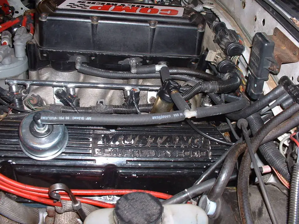

Jason, I read your link that was posted, and I think I'm going to try adding another pcv valve to my drivers side valve cover. Have you done this with good success? Will I need a baffle under the valve in the valve cover? I'm going to try this soon, and will post the results.
Joe
Joe,
The second pcv worked awesome for me.
I was filling my Home Depot oil spearator within 1 tank of fuel...
Once I put the second pcv in, I did not accumulate any significant amount of oil in the separator.
(I still had oil issues due to valve seals though...)
You do want some kind of baffle on the valve cover pcv. If you look around enough you should be able to find a valve cover cap, which has an integrated baffle.
The one I found was tall, but was baffled.
Here is a pic of my final setup...
