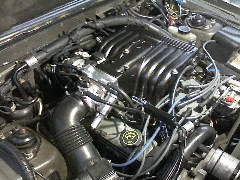

Can you guys post pics of any Explorer or GT-40 intakes

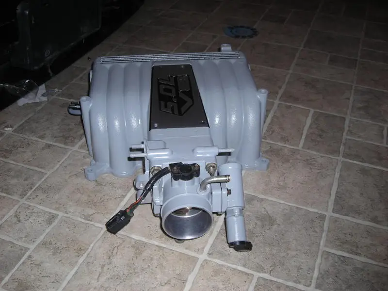

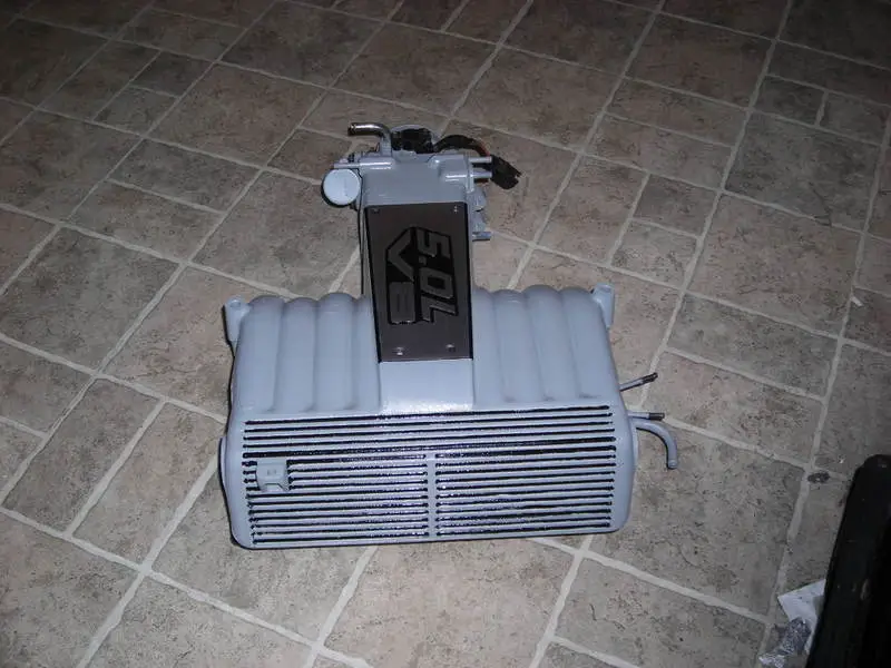

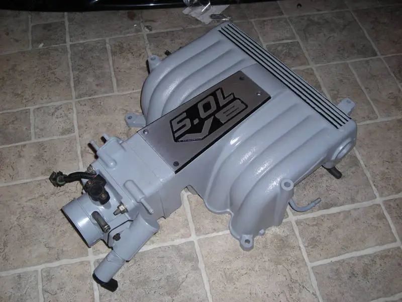

here yous go
is that much better than stock or would it be worth my while to spend more money and get something better. I can get teh same intake and the 65mm TB for a decent price but if it's only a little better than stock would it even be worth my time
The Explorer flows 220 CFM, much better than stock. The Explorer and GT 40 flow almost the same. I would highly recommend the swap.

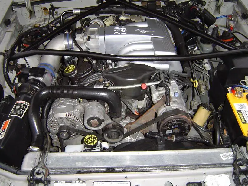

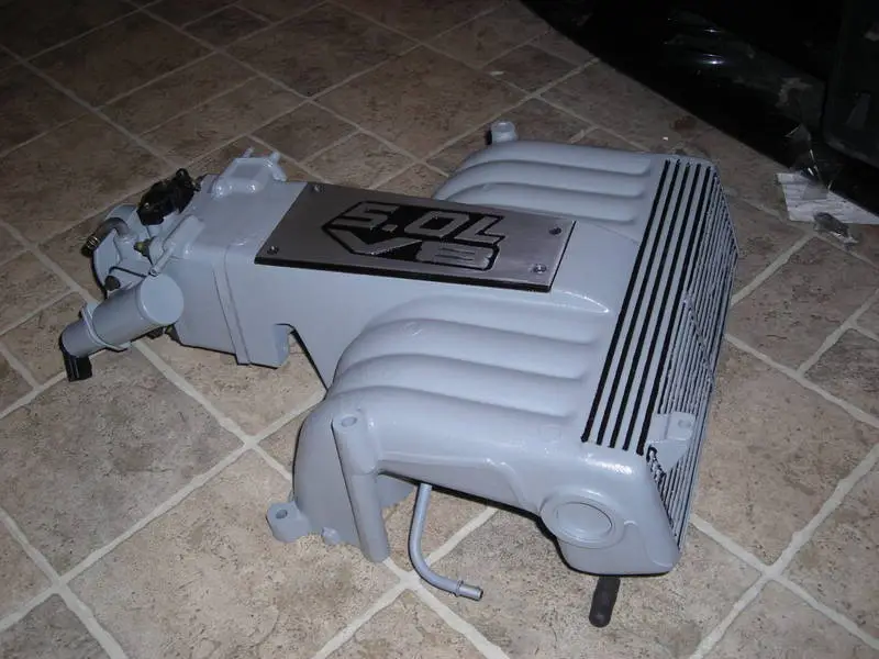

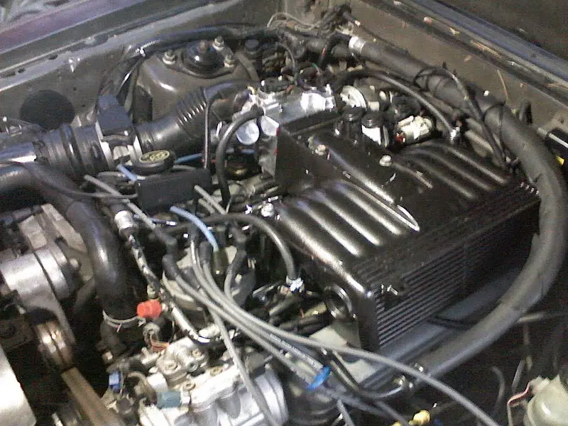

I have one painted tomatch my car,all I have are crappy phone pics taken right aftre the install but w/e and I've done some cleaning/painting since these were taken
