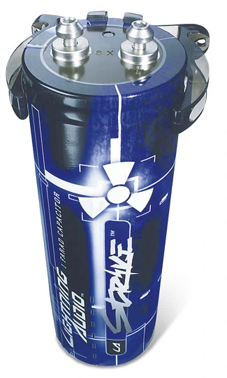

It think you need a capacitor. Basically it's another batttery dedicated to your amp. Should be lighter than adding a second car battery
http://www.crutchfield.com/S-MemwE4...re=true&g=710&I=495LS103&search=capacitor#Tab

Do not buy a capacitor. The amount of energy stored in a capacitor doesn't even come close to the amount of energy stored in a 12V battery. The only advantage to a capacitor is that it's able to deliver it's energy (and recover it) at a very fast rate.
Unless you are getting into SPL competitions (where they play a single tone for a split second) a capacitor is useless. Put the money towards a 2nd battery before you buy a capacitor.
If you are planning on using less than 1000 watts, I'd just install a 100amp alternator and make sure your battery is in good shape.
As already stated, but I'll gladly back it up.....
Ditch the capacitor idea. WORTHLESS on a car of this nature, and a second battery is MUCH more beneficial if needed. However...
