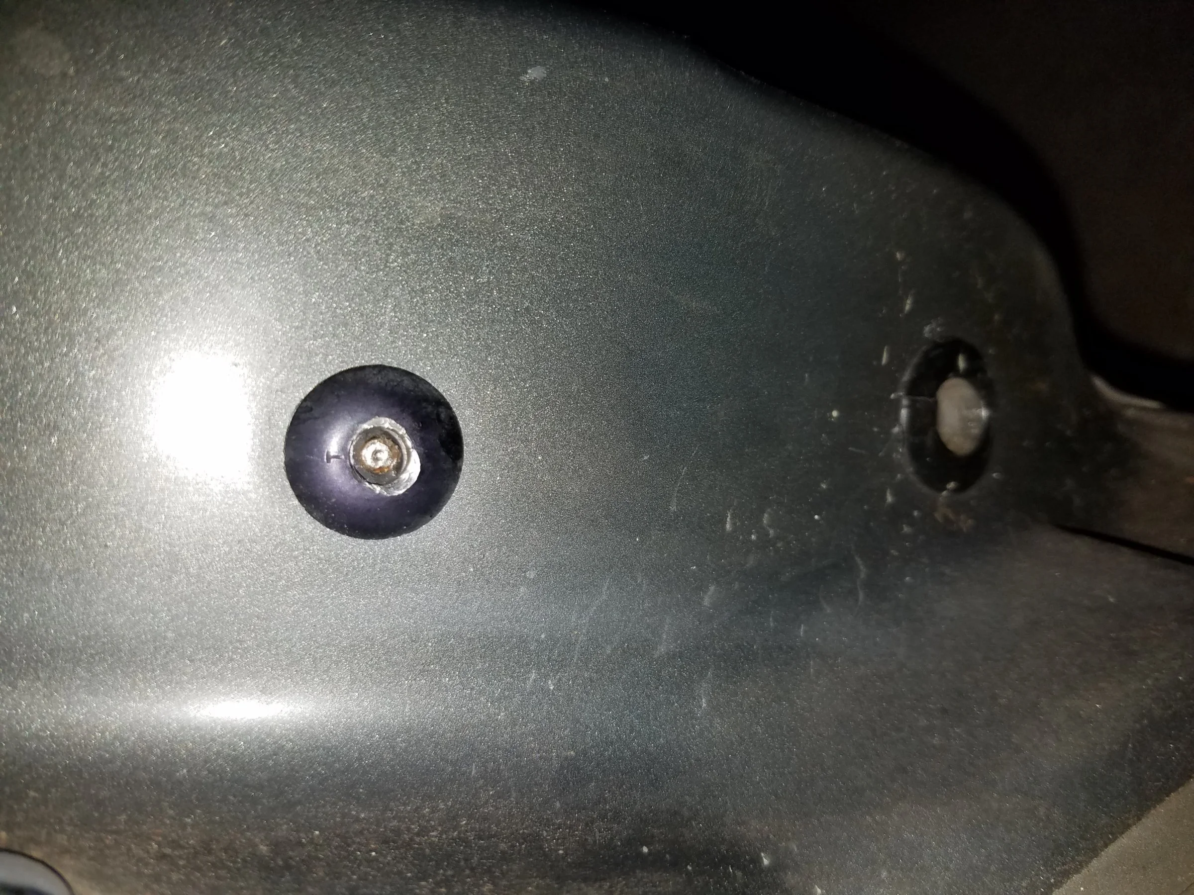

Bought a new door lock actuator for my fox and can't get the old rivet that's in the door out. From looking at it, it looks like someone already put a new rivet in. Any tricks to get it out?
Use a pin punch to drive the stem out of the rivet and the use a 1/4" drill bit to drill the rivet out. I usually try to find a suitable bolt to replace the rivet.

I just removed mine on the passengers side. I just sprayed wd40 on the mounting points. I then spread the rubber mounts outward and wiggled and twisted the actuator somewhat and it came out. It was alot easier than I thought. You don't need to drill the rivets out. It makes it a lot harder since not everybody has a rivet gun.
