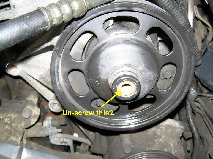

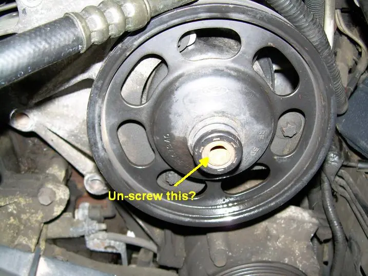

do you just pull it off or do you have to unscrew the thing in the middle of the pulley first?

If you don't use the specific puller for our cars you stand a chance of damaging the pulley when you take it off.
Also pay close attention which side is front so when you re-install you don't put it on backwards.
You can rent a puller from local parts house or they can be found on the internet for 10 to 20 bux.
Grady
No No No :nono:
That is not the specific puller you need :(
That is a general all purpose puller.
That one will do damage :fuss:
You need a power steering pump pulley puller for a 94-95 Stang.
Look at harbor frieght on the internet for a pic or go to your local parts house and ask for the SPECIFIC puller.
Grady

Chris the power steering pump pulley puller PN is 25298 from Autozone (Pulley Puller Installer Kit). I think I paid about $15. The one they had for rent was all jacked up. So I purchased one. The kit is an 8mm forcing screw for our cars. And no you don't unscrew it you pull it off. Oh and only use the correct tools - makes life alot easier and cheaper if you know what I mean
i will definately not use that other puller on it. and it cost like $45 too so i'll save some money too
thanks to all for the advice
