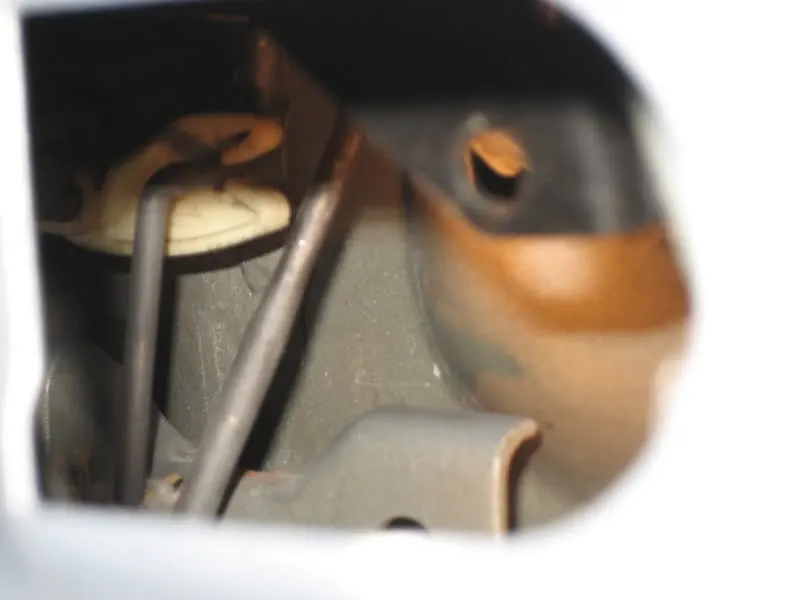

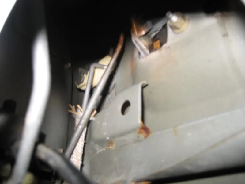

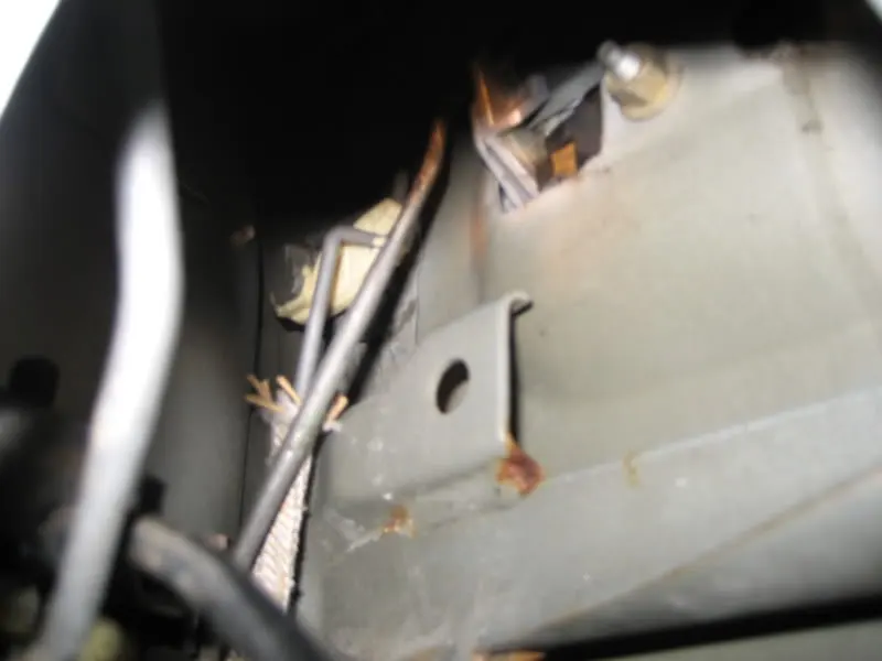

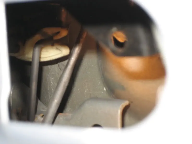

Ok. I got it fixed. Thankfully, nothing was broken. The slim jim worked, but not necessarily the way it was designed to. (I "fished" around with it and then decided to hit the button on the remote. ;) Must have knocked the jammed rod loose.) You can see the white plastic piece with the rod going through it. That's what had popped out.
