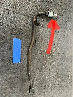

Just remove the piece I’m pointing to, and find a brass cap at the hardware store of the same thread. Easiest way!
