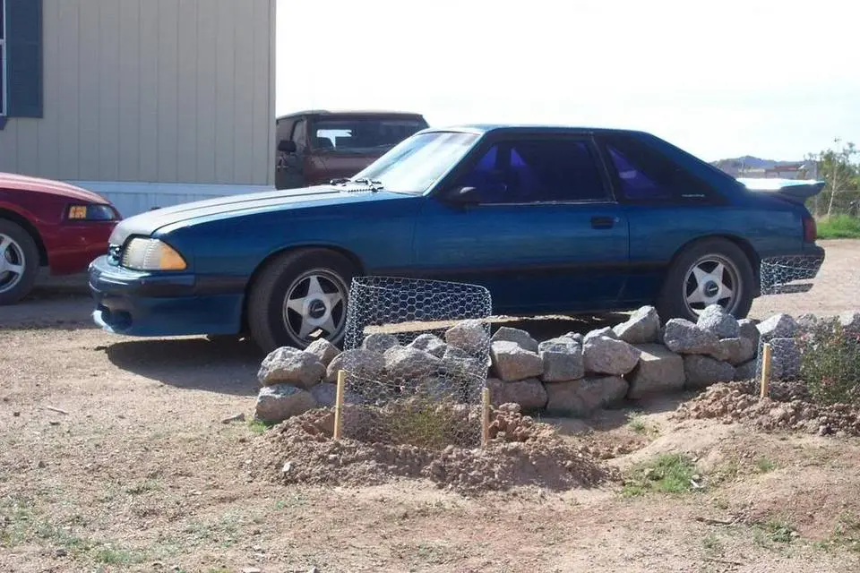

Here's my Capri. My X and his brother converted it to a Mustang. :nonono:
On a positive note, I'm in the process of converting her back. I just found a front clip and a hood for $150.00.
