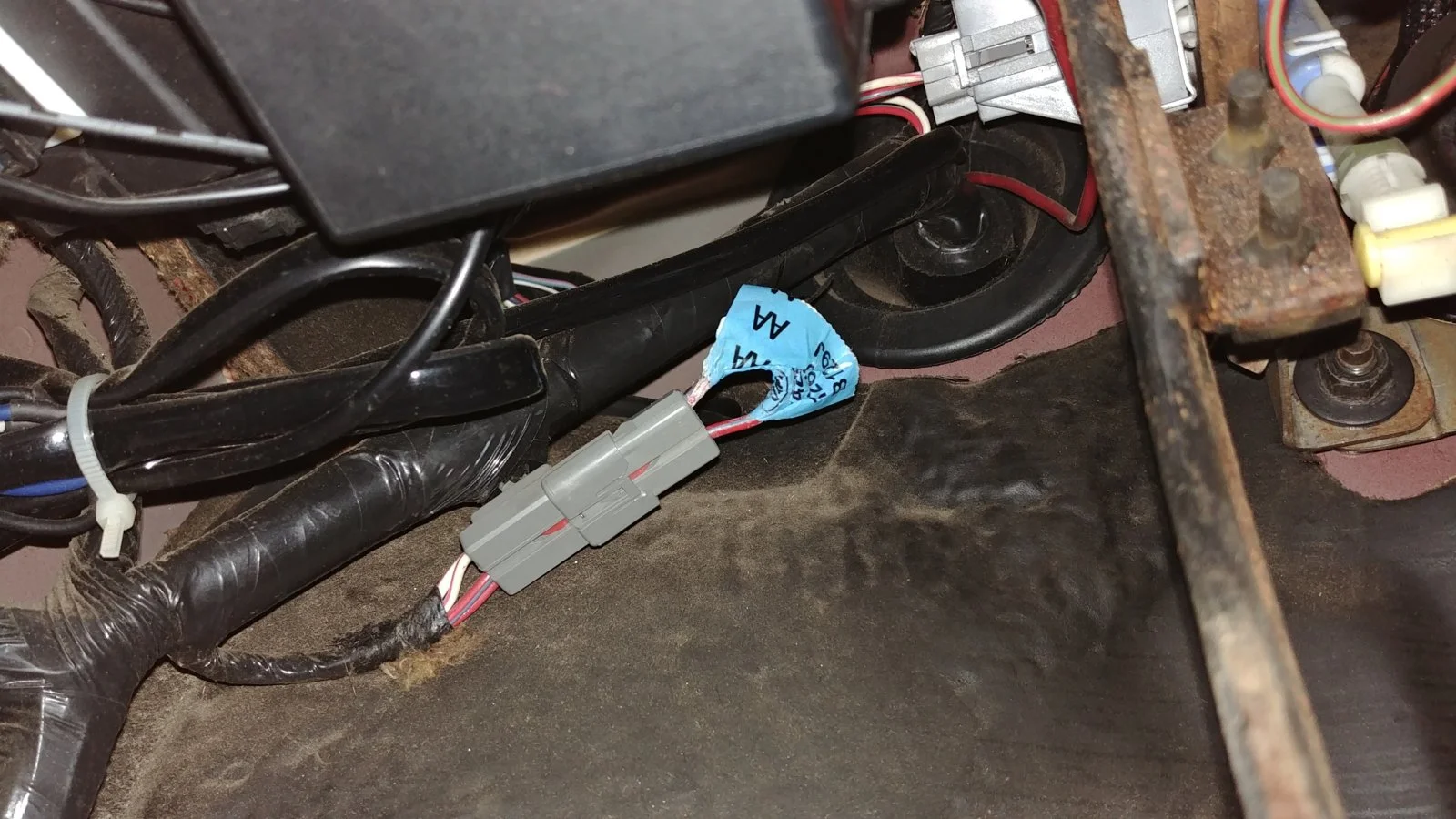

So you're saying that it'll start in gear, foot not on the clutch. Like the starter turning the engine over moves the car forward? As far as I know the 94-04 T5s don't have neutral safety switches, clutch safety switches only. If the car was an automatic before the fox drivetrain swap(5.0 with t5 I'm assuming), there is a two pin connector with a jumper wire above the drivers side kick panel. When I t5 swapped my 2000 v6 I had the same issue, just removed the jumper connector and it won't start without the clutch depressed. I'll provide you a picture. Also if the car was an auto and they swapped the pedal assembly, the clutch switch might be disconnected.

I do have the connector under the dash your pic shows.
My man ! I pulled that jumper and clutch safety switch works ! Exactly what I wanted just Incase they check at tech inspection next year ! Thanks again !
