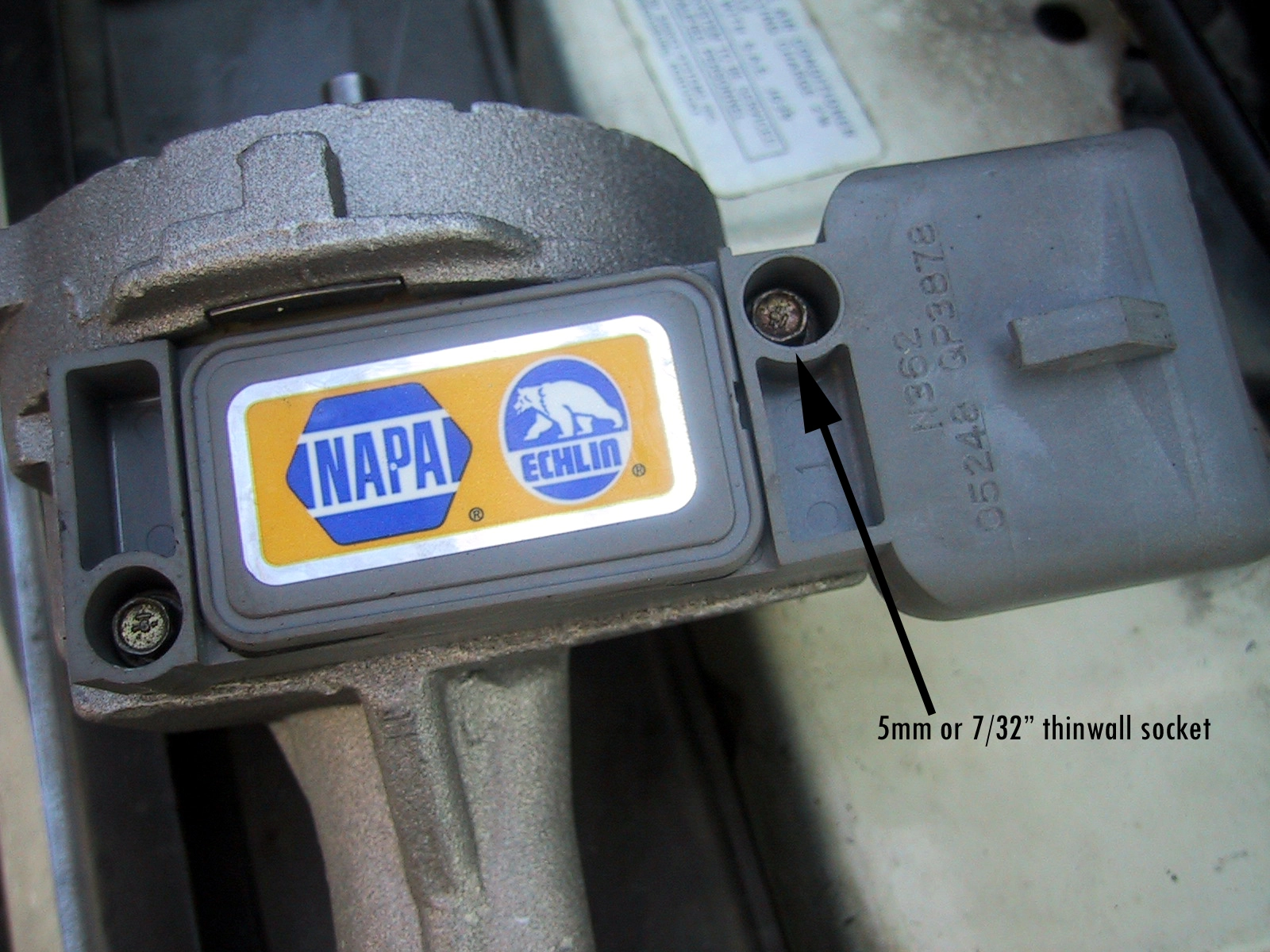

I'm not great but I'm fairly capable what is the procedure for changing the module?
It’s pretty simple really
Just make sure to use a very good thermal paste (not the grease they include with the new module.) when you reinstall
Also, Check Engine light on? Checked for codes?

Go through the list first to familiarize yourself with it, each step is oriented and will lead to the next step, seems daunting at first but it works, the guru that put it together knows his stuff (can't remember his name :thinking:) it shows you how to check for codes too, saves you from wasting money and time although likely causes are pip in the distributor or the module that raggity showed a picture of.Now
