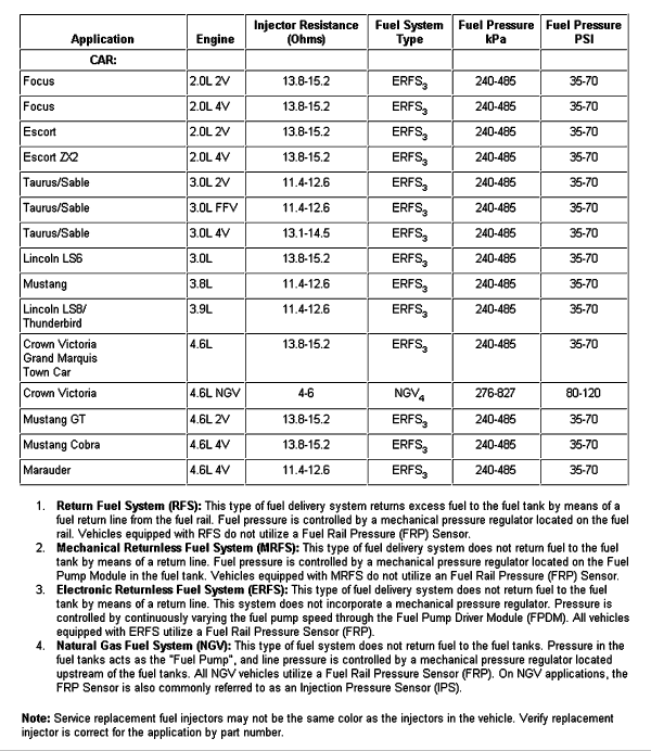

i've had that prob for a while now, it's kinda embarassing at the gas station. FWIW my fuel pressure at idle bounces arond 32 psi and i think that might be a little low

From what I read, the fuel pressure should be between 35 psi and 70 psi for a 2003 GT Mustang. I will recheck that value and re-post here. Good luck, Tommy.
Fuel Pressure Chart!
Here are some Ford fuel pressure values from AllData. Click on the bar above the chart to enlarge it. Hope this helps!
