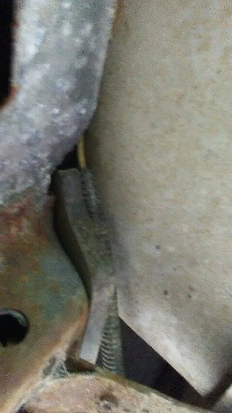

I noticed where the fuel tank is mounted a wire is pinched there. I have posted a picture of this not sure what wire this is but it looks to be wedged in there pretty hard.

Can't tell you anything about that wire, your gonna have to loosen the tank straps and move it to look for damage.
