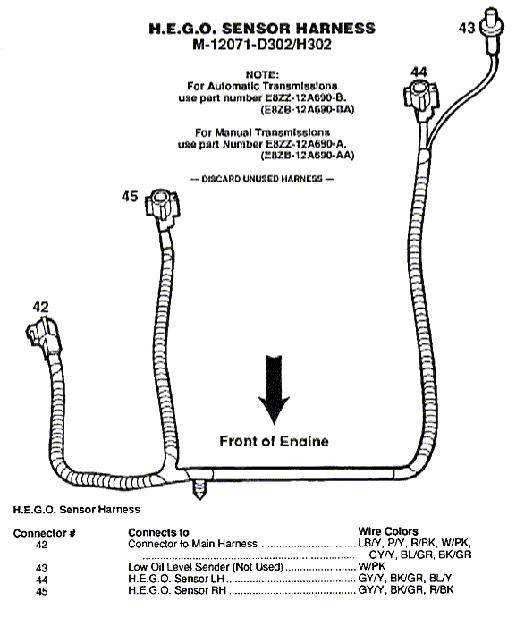

You may have a automatic transmission O2 senor harness. That would account for the no crank condition. See the drawing below and check the part numbers on it against the part number on the O2 sensor harness you currently have.
O2 sensor wiring harness
http://www.veryuseful.com/mustang/tech/engine/images/mustangO2Harness.gif
