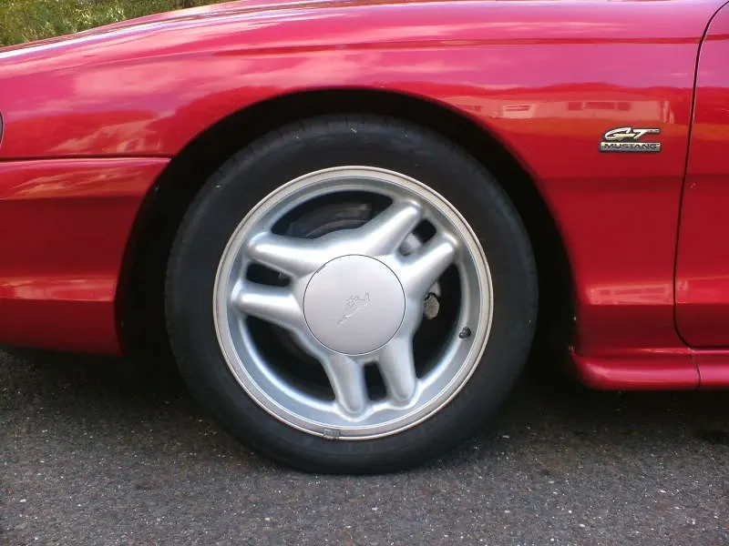

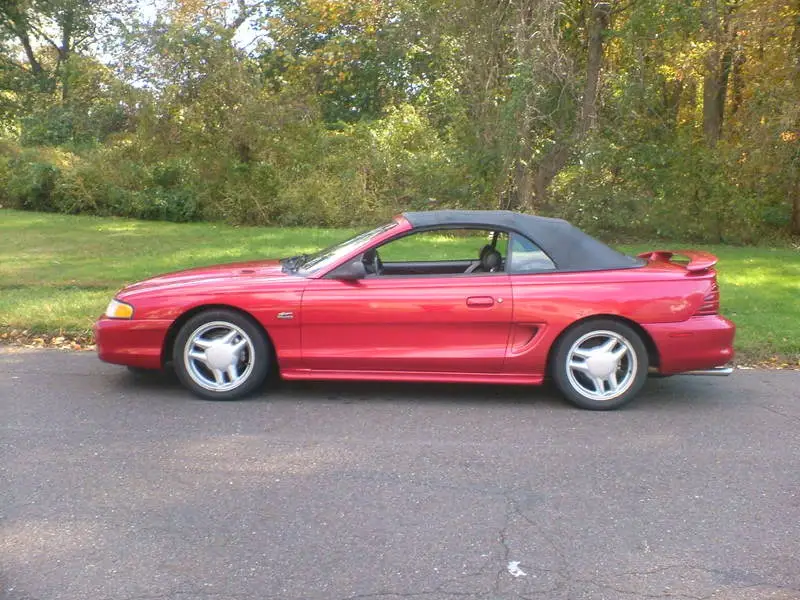

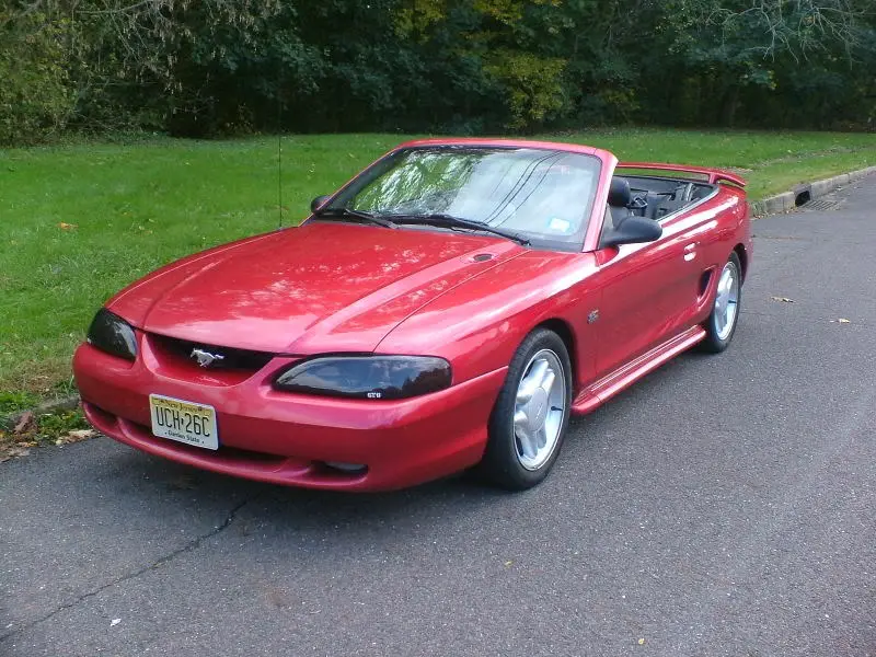

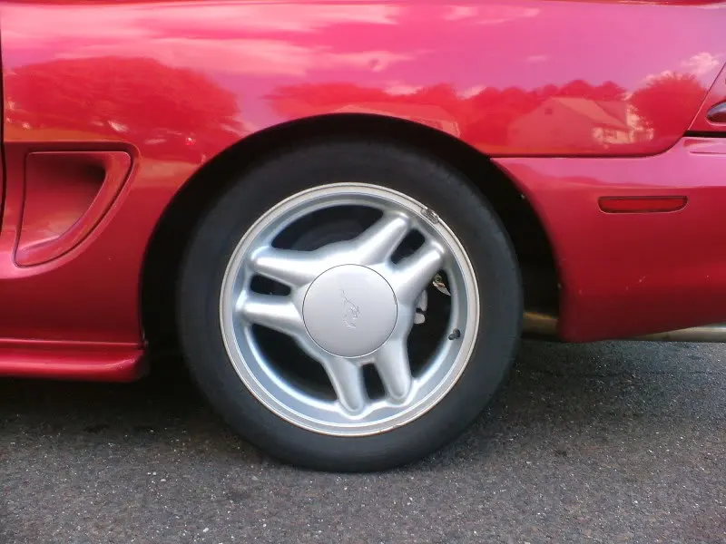

Alright finished lowering the car today... actually knocked out the entire rear in about an hour... makes me feel goooood... now... if anyone rembers that scrape/grinding noise i was talking about.... yea its worse now... if im at even half throttle or co over a bump while in gear my car makes a scrapeing/grinding noise... and its annoying as hell... i assume that since it got worse when i dropped the car that it must be driveshaft/rear diff related... anyone have this problem....
ANYWAY NOW SOME PICS:

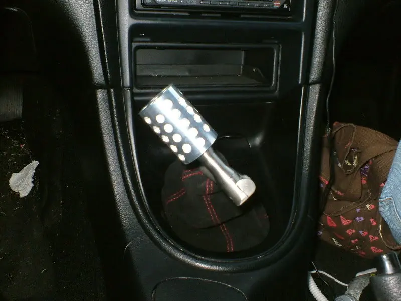

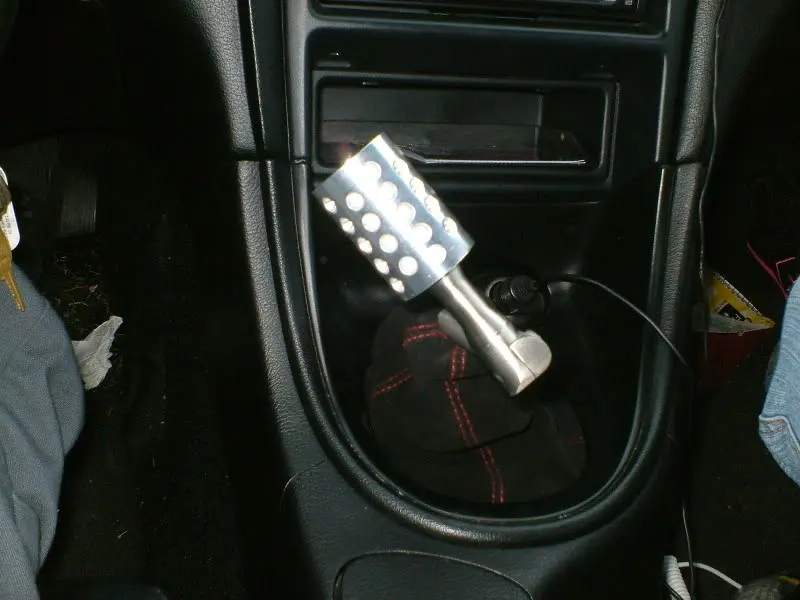

Shifter:(dont mind the dirty ass floor)

yea... thats the g/f's well we just had a huge argument today... so i really dont know that for sure.... Ride is a little harsh... but nothing as hard as compaired to the drop zones on the probe... i can actually feel an improvement in accel after i shift which is awesome...
The Green GT said:
After looking at your shift boot, I think Ill try to make me one from a Crown Royal bag.
Little thicker then that, but it might work lol
http://cgi.ebay.com/300-crown-royal-bags-unused-new-750-ml_W0QQitemZ220016890355QQcmdZViewItem
Oh and ben your drop looks sweet i saw it from my g/fs comp but it wouldnt let me post anything....

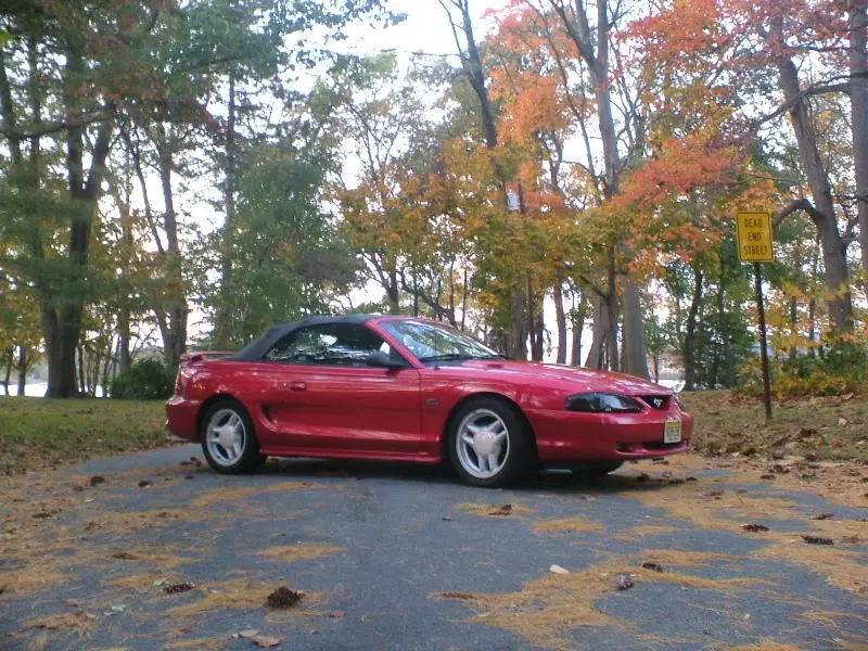

Well i wanted to cool down after the fight with the g/f so i went out and took a drive and came accross a place for some pics!!!!
MORE!!!!: Best pic to date i think....
