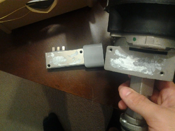

The white stuff was heat sink compound. It is important that it is there and spread evenly. It helps keep the TFI module from overheating. If the TFI overheats, you could have problems like the ones you are describing.

Ok cool, I picked up the cheap heat sink compound stuff from radio shack today for a couple bucks just in case, do you think I should go back and get the artic silver thermal compound? I ordered a new TFI from the parts store but it looks like it just has a packet of dielectric grease in there, i'd rather use something better. I really want to get the best stuff I can get so I only have to do this once. I just pulled the dizzy and took off the TFI and saw there is only a little bit of residue left on there. So whats the best stuff for this purpose, the arctic silver thermal compound or just regular cheap heat sink compound. Thanks guys, I am almost positive this is my issue.
This is how much was on there.
