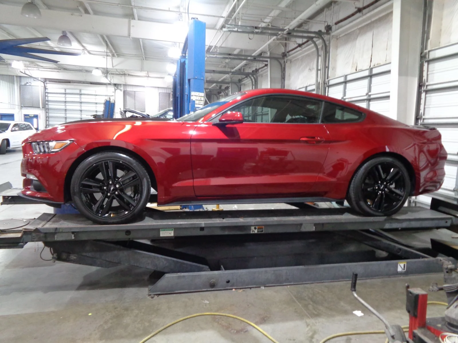

Hey ya'll im new to the site and just wanted to throw out my car and mod's.. I have a 2015 ruby red PP ecoboost with a roush CAI,MAP billet intercooler , resonator delete, denso 1 step colder plugs and a cobb stage 1 93 oct tune with a auto trans ... runs really good and all the mods work good together.... getting ready to do the oil change... everyone enjoy your car's !!
