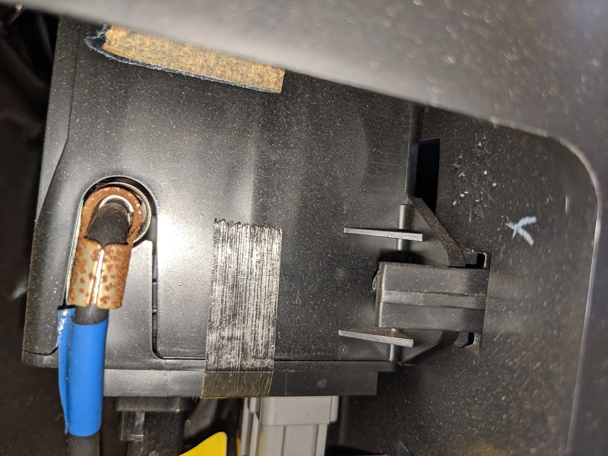

Hey all,
So I've recently purchased a 1998 Mustang V6, and have an issue with the programming steps for remote programming. I have the trunk 'liner' pulled away, with access to the two pins I need to short to get the car to enter learning mode. However, when I short the pins, nothing happens. I've tried doing this with a variety of metal objects like screwdrivers and small sockets but nothing seems to work. I've also tried with the car in battery and with the engine running. Anyone have any advice?
Thanks

To confirm the ignition switch is in run or ACC? Confirm that the doors do not lock and unlock when shorting pin is shorted. Confirm IF both doors will lock/unlock using the door key.

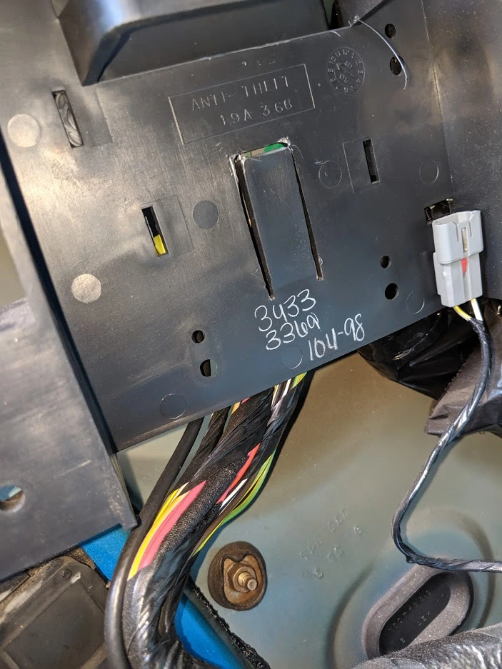

I'm certain that what I'm shorting is correct, as you can see there's the keyless entry module behind the metal shelf/sheet, and the small grey box up at the front is what I'm instructed to put a paperclip across both terminals. And yes, both the manual and power locks function as intended on both boxes. If the car has the module, then it confuses me as to why this doesn't work
Are you sure that the two wire connector isn't actually two pieces? And what you are supposed to do is to separate the two pieces, turn the shorting plug around and insert the shorting plug into the connector?
Can you elaborate? Do you mean there's a plug that I'm supposed to take out of the module instead of just shorting the one that's visible in the first image?
