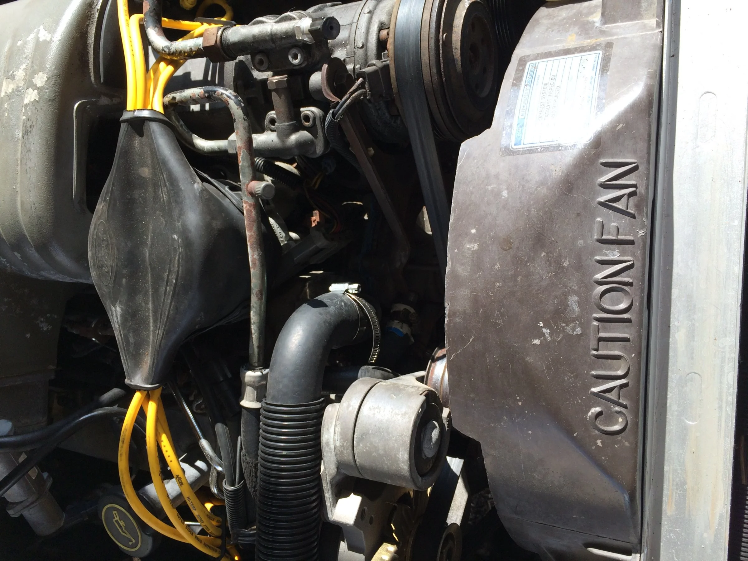

I don't have any really good shots. I'll take them later and upload, but I do have one that shows the top of the fan shroud:

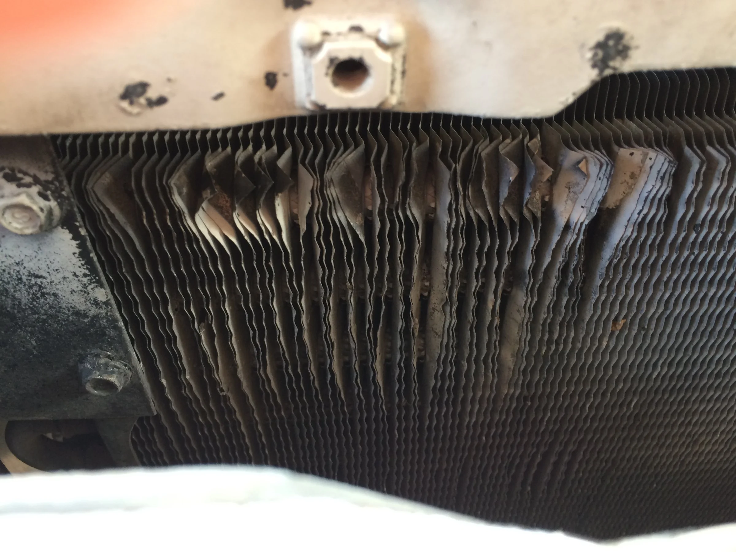

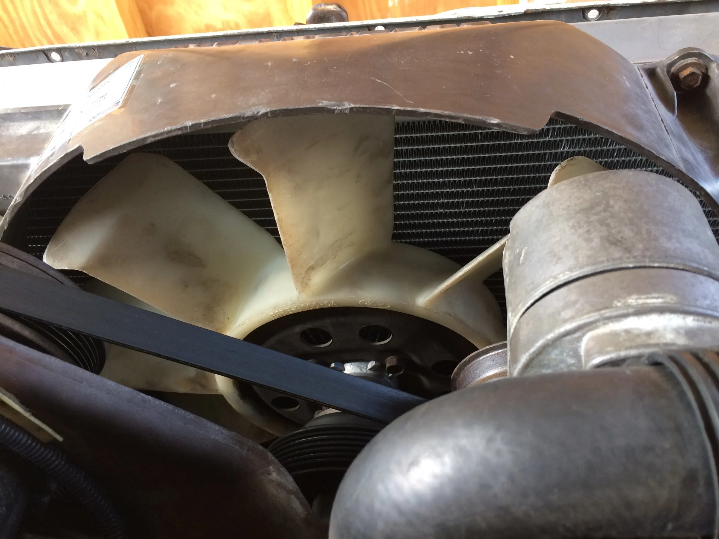

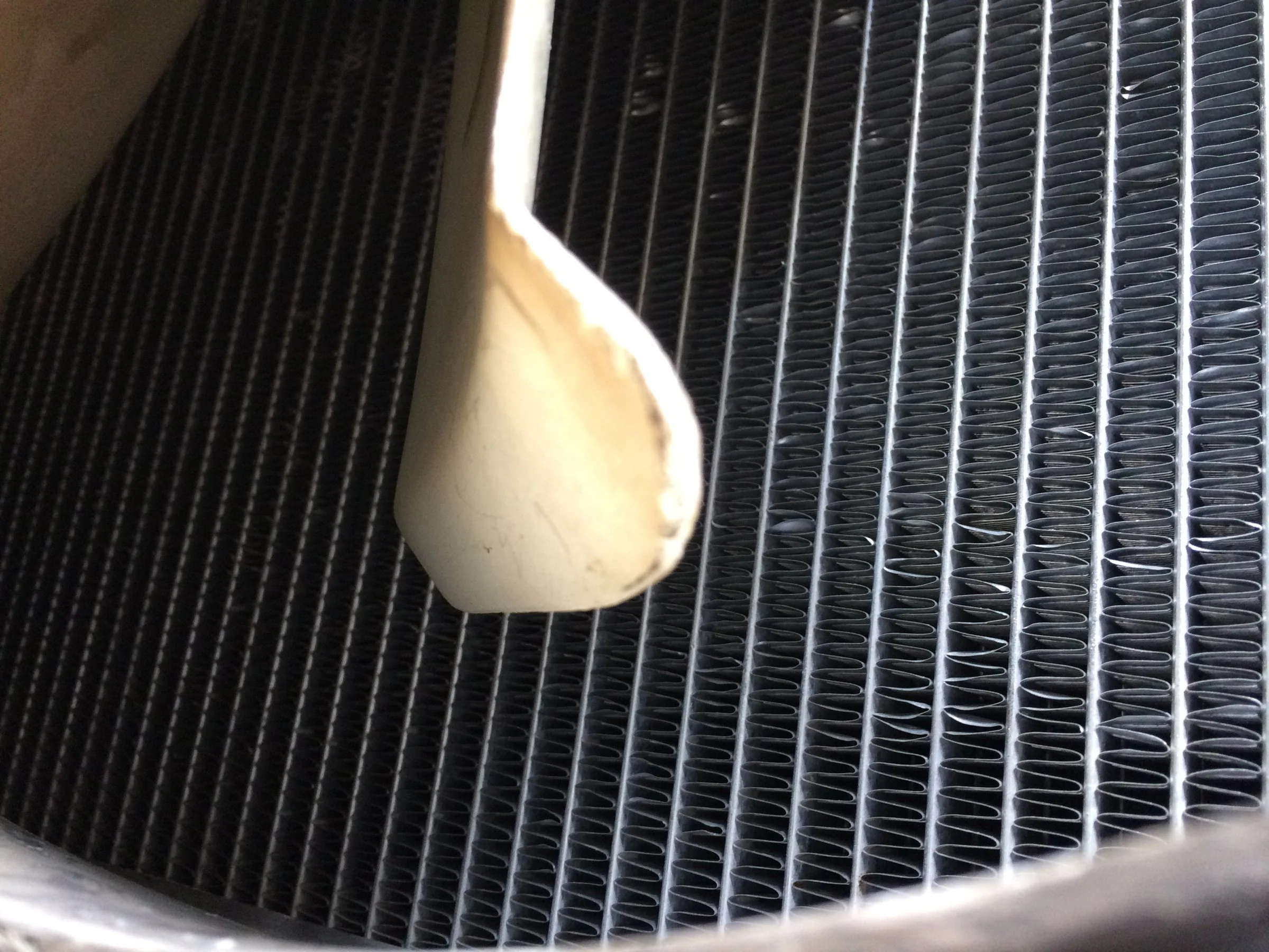

Ok, so stock fan shroud. I assume stock fan? When the car is hot, shut the engine off, then grab the fan and spin it. It should have a lot of resistance and stop immediately when you let go.
As for condition of the radiator and condenser, if the fins are bent and folded over, air doesn't pass through. I'd spend some time straightening out all the fins on the condenser and radiator. You may need to remove the fan and shroud, and tint the radiator in towards the engine to access the front side and straighten them all out. That assumes, of course, they are all bent badly.

Here are pictures of the radiator and the condenser. The condenser is in far rougher shape.
Condenser, worst part in top left corner:
As an added update, as I was taking my car in to have the AC done, I punched the gas when pulling out, after having driven it about 3 miles. It got up to speed, and the temp immediately soared up to 270, and just a hair from the red. It sat there for about 19 seconds and then went down slowly in the next minute or so, back to half. It stayed there, then came back up to its usual 230ish running temperature. When I came to a stop, it went up a little, then hung back at 230, but didn't seem to be trying to overheat as I sat there.
I turned the car off and spun the fan, and it had a lot of resistance to it.

Also yes, stock fan, sorry I missed that part. Stock fan and shroud
