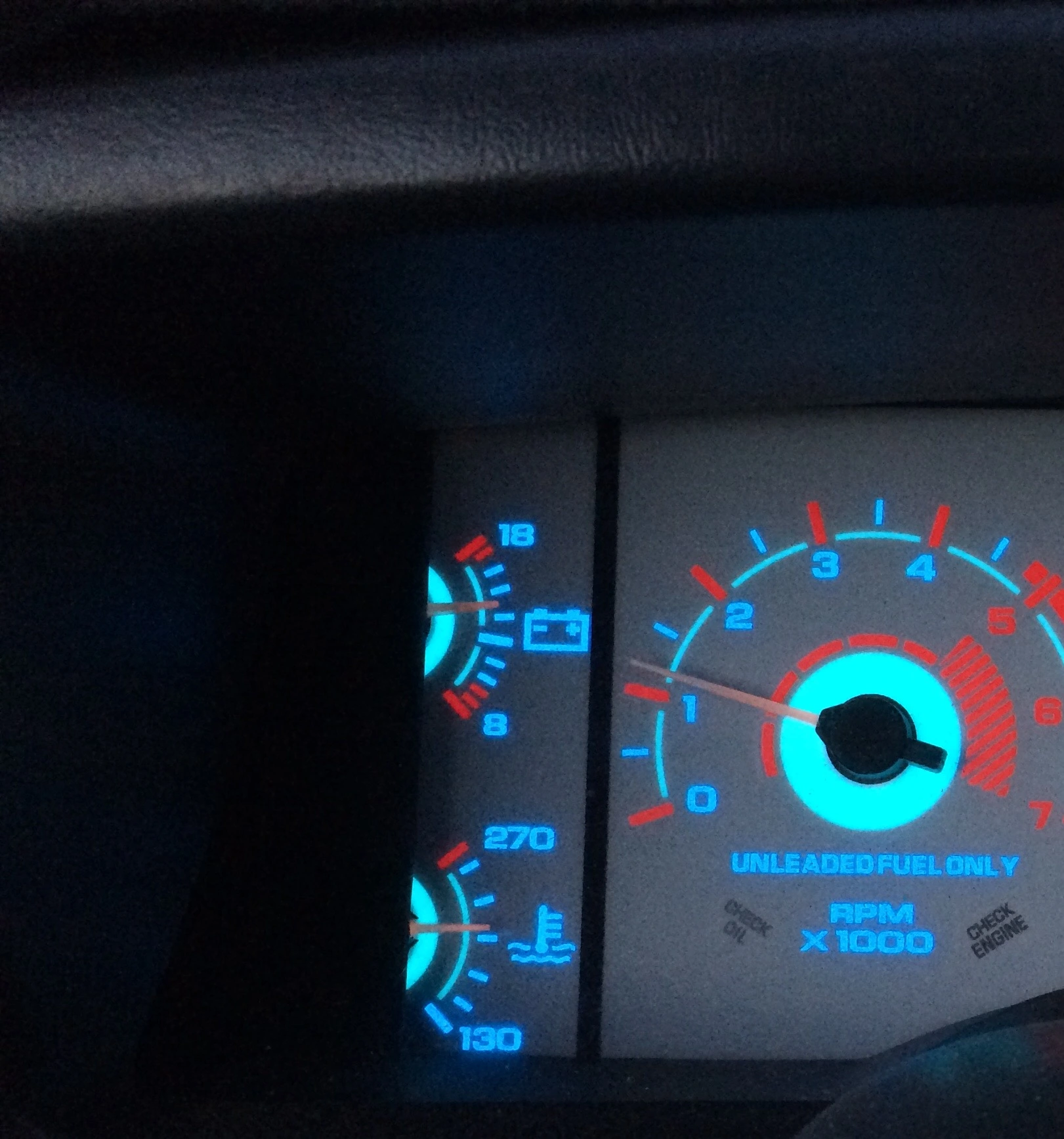

I don't understand why it's still running hotter than it should. Here's where the temp normally dances around.

Alright, drained the coolant out and re added. Now it's diluted a little more than 50/50.
Started it and revved it for a little bit until the fluid in the radiator started going up and down, closed it up and watched. Temperature went up to halfway between the half and 3/4 mark (220-230 F) and stayed there.
Now, when I had the stock radiator and stock thermostat in, it ran and stayed cool just fine. Now with aftermarket and performance parts, it seemed to start this, by coincidence I don't know. It was also around the time the heater core went out, which has since then been replaced. I'm baffled.
