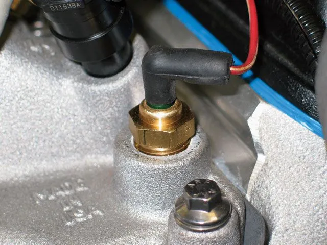

The sender for the dash guage is the small sensor on the very front of the driver's side of the lower intake.
Make sure it's clean and there's a tight connection here. If you get an aftermarket guage, install it here. You can just pull the wire off and let it hang. Dash guage will read nothing, but you are using the other guage anyway
Oh! I looked at that yesterday because I noticed the black connector part had a split up the side where it fits onto the sensor. I wiggled it and it didn't seem loose, but it could still be causing an issue, I'm not sure.
But okay, thanks for the tip. I'm really interested to see if it's just been the dash all along

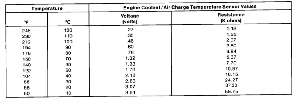

Also, with the gauge sensor (not the EEC temp sensor), it is grounded through the block. I noticed last week my oil pressure and temperature gauges both were hovering higher than usual with no other side effects. I verified my fan was working properly and coolant level was good. I noticed one of my engine ground wires was not in good shape so I cleaned it up real nice and re fastened it and boom no more "overheating". Gauge reads right in the middle now. So yes check the wiring to the sensor AND engine grounds.
If you want to verify the real temperature you can also use T pins and a volt meter to measure the EEC's temperature gauge (mounted on the black heater core pipes above manifold). The service manual has the voltage/resistance chart to read the temperature.
