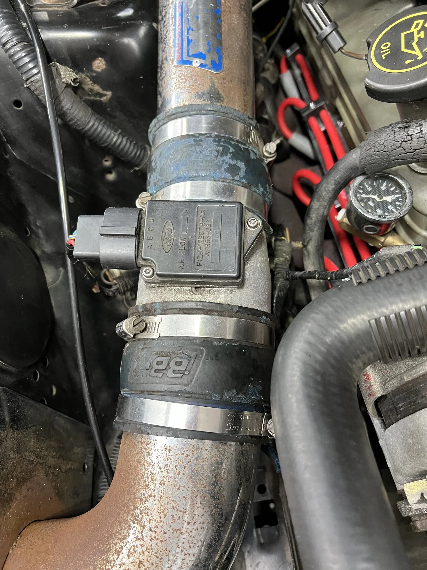

Firstly,you need to verify what MAF sensor you have,that will dictate what injectors.
Like others have said, you need to verify your MAF calibration and injector setup. For an aluminum headed H/C/I setup like you have 24lbs injectors should be bare minimum with 30s being a better option. The 155 lph fuel pump will be fine.
The MAF is on the intake tube right after your airbox. If it's aftermarket it should be printed what #injectors it's for.

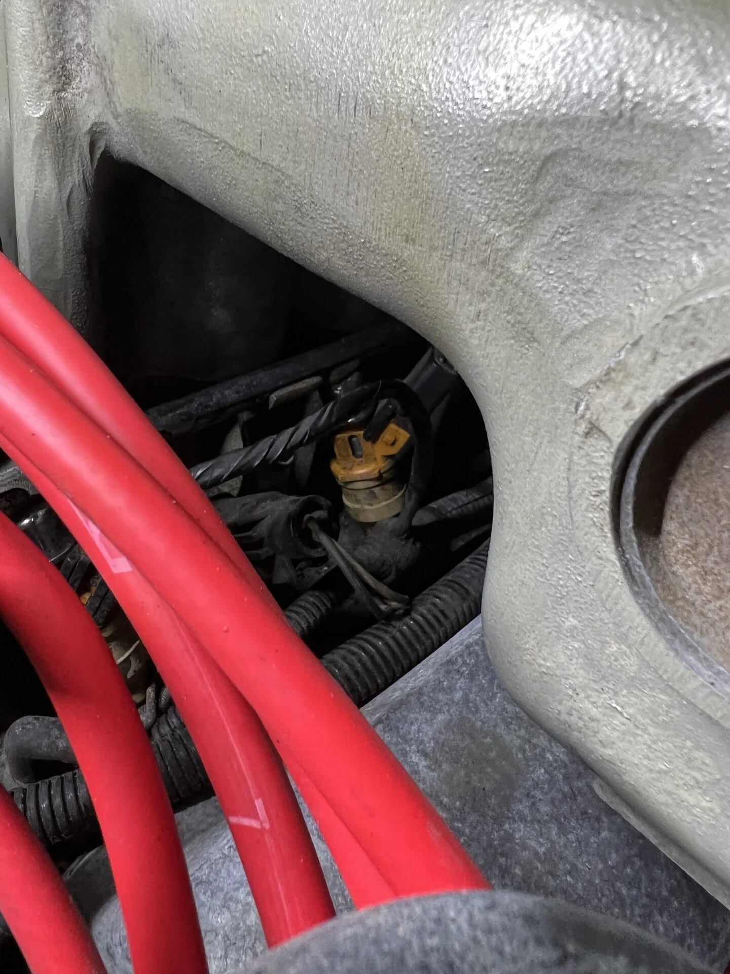

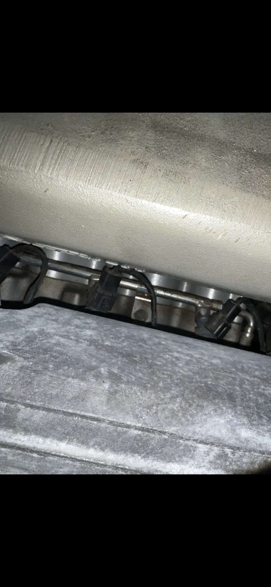

Ok so here’s some pics of my maf, the old light blue injectors and the new injectors. That maf looks stock so I think I’m good?
