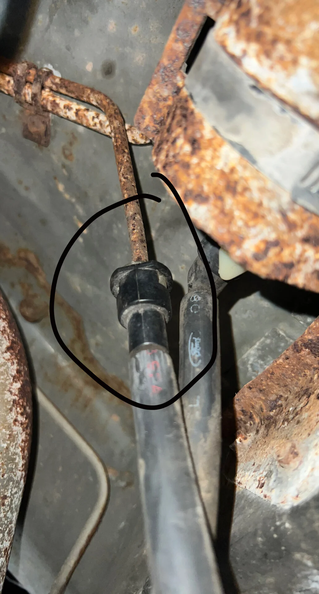

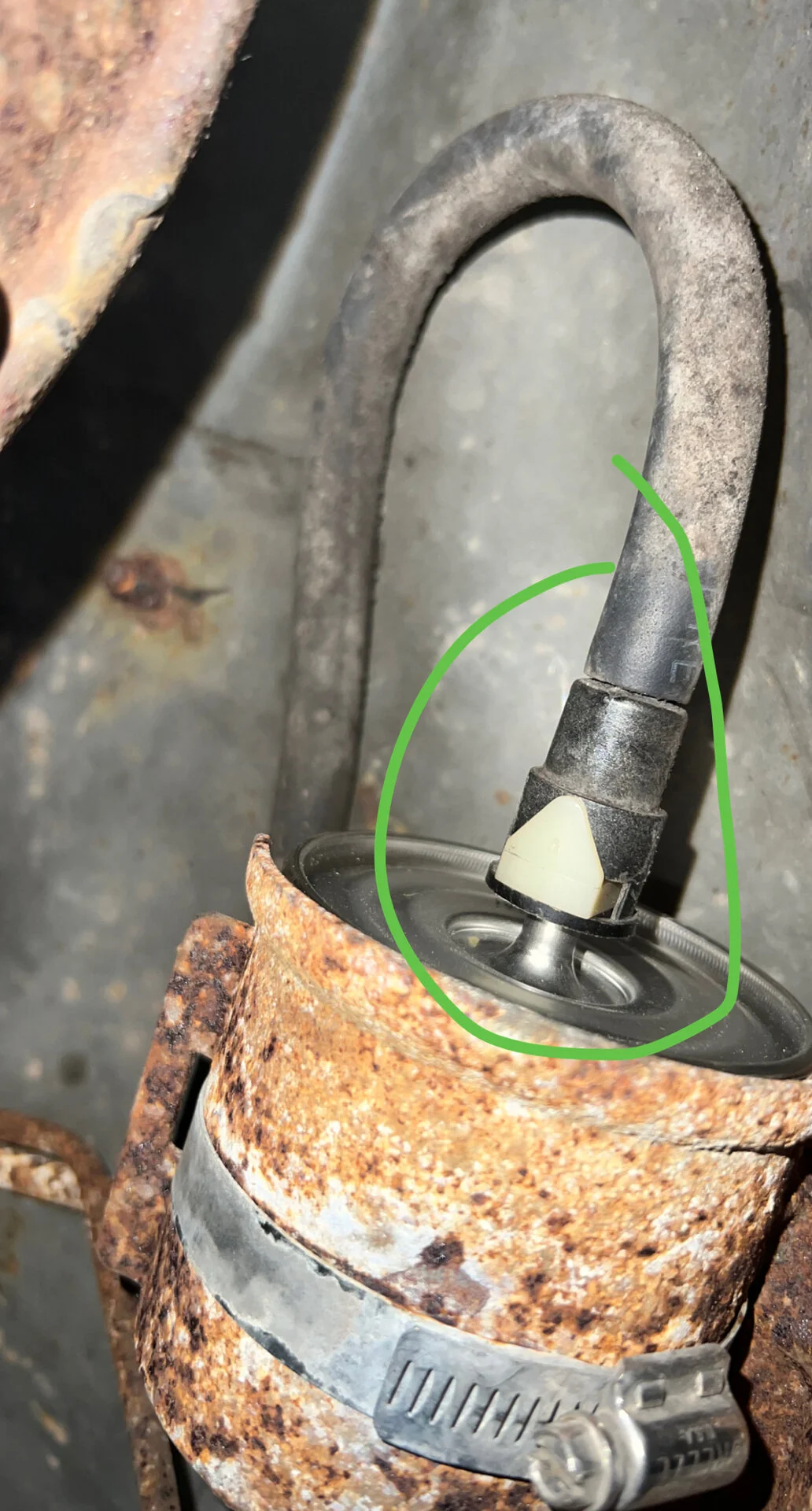

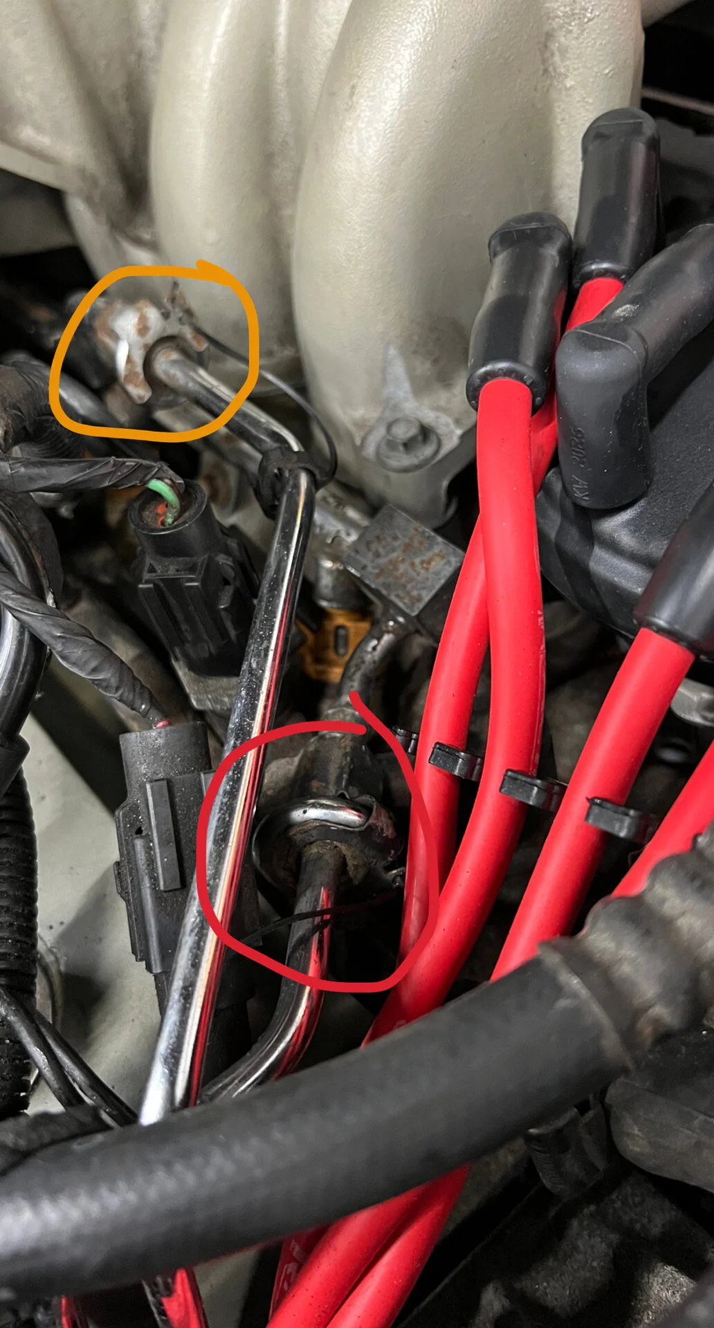

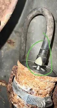

Thanks man I’ll definitely keep that in mind. In regards to cleaning the fuel lines could anyone show me exactly what I have to disconnect and where I blow the air through. I just wanna make sure I don’t blow air in the wrong line and make anything worse haha
Ok so I found all of the fuel lines I took pics of them just to confirm they’re the right ones. So which ones do I blow air in and do I blow it on the side that has the connecter or the side with just the tube?

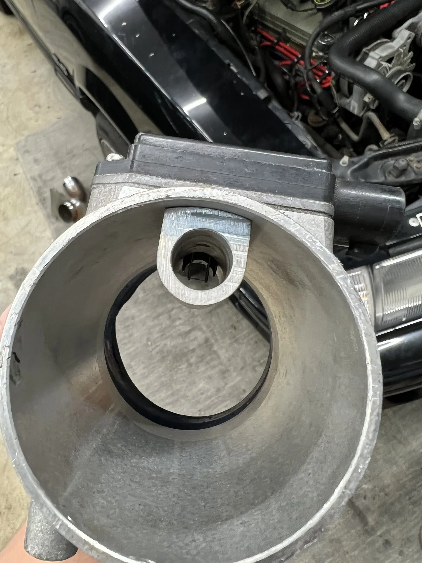

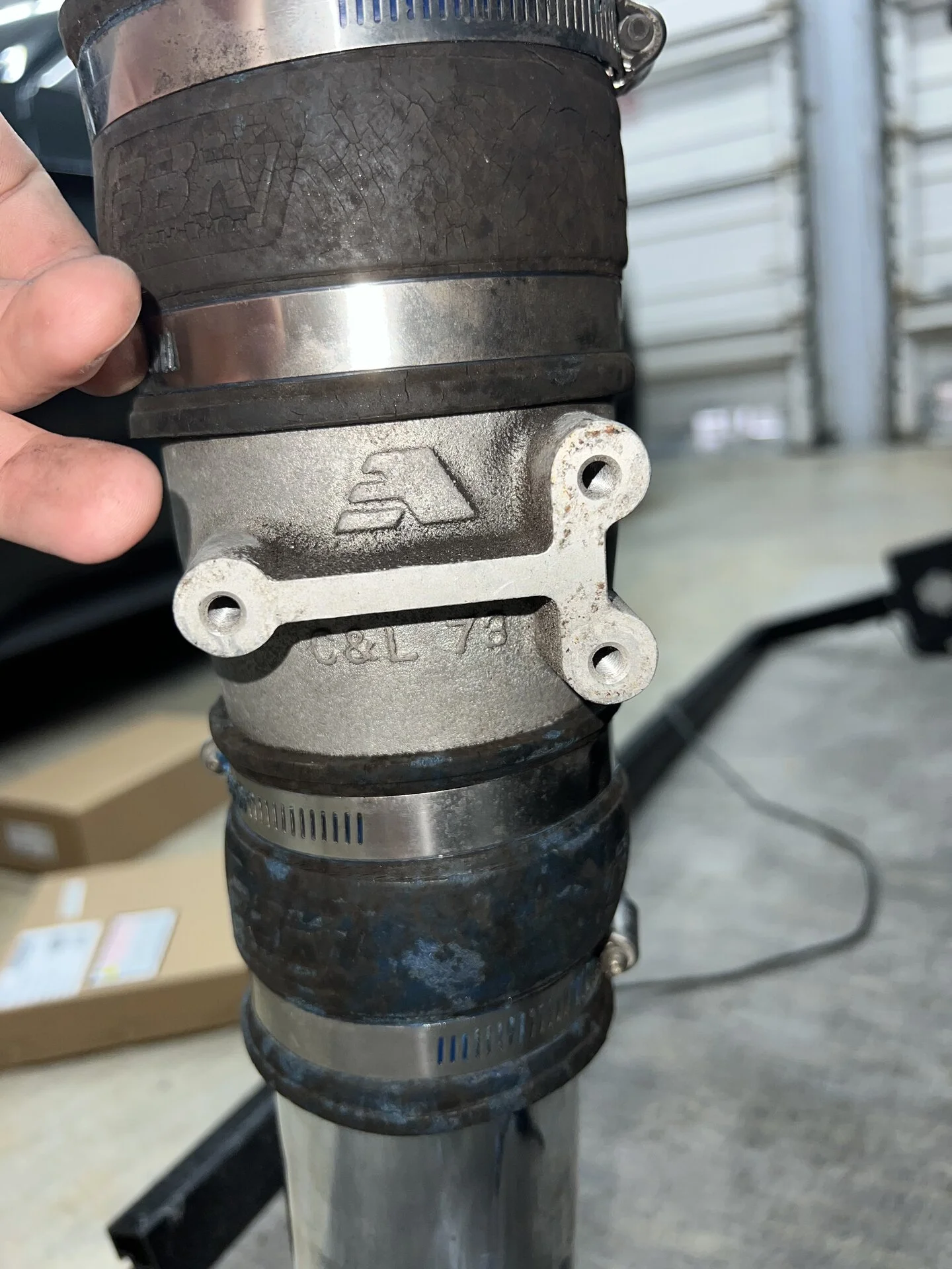

Ok so here’s some pics of my maf, the old light blue injectors and the new injectors. That maf looks stock so I think I’m good?
You have the stock MAF electronics, but you have a C&L MAF housing. The housing has a sampling tube that can be changed out depending on what injectors you are running. You need to pull it and look at the color on the sampling tube to understand what you're dealing with. Here's the chart:
My recomendation is to ditch the C&L and the cold air intake. Buy a ProM meter that's calibrated for the injectors you buy and pick up one of the LMR factory air box reproductions.

Looks like I have the black tube which means 24lbs injectors. Great eye bro thanks alot

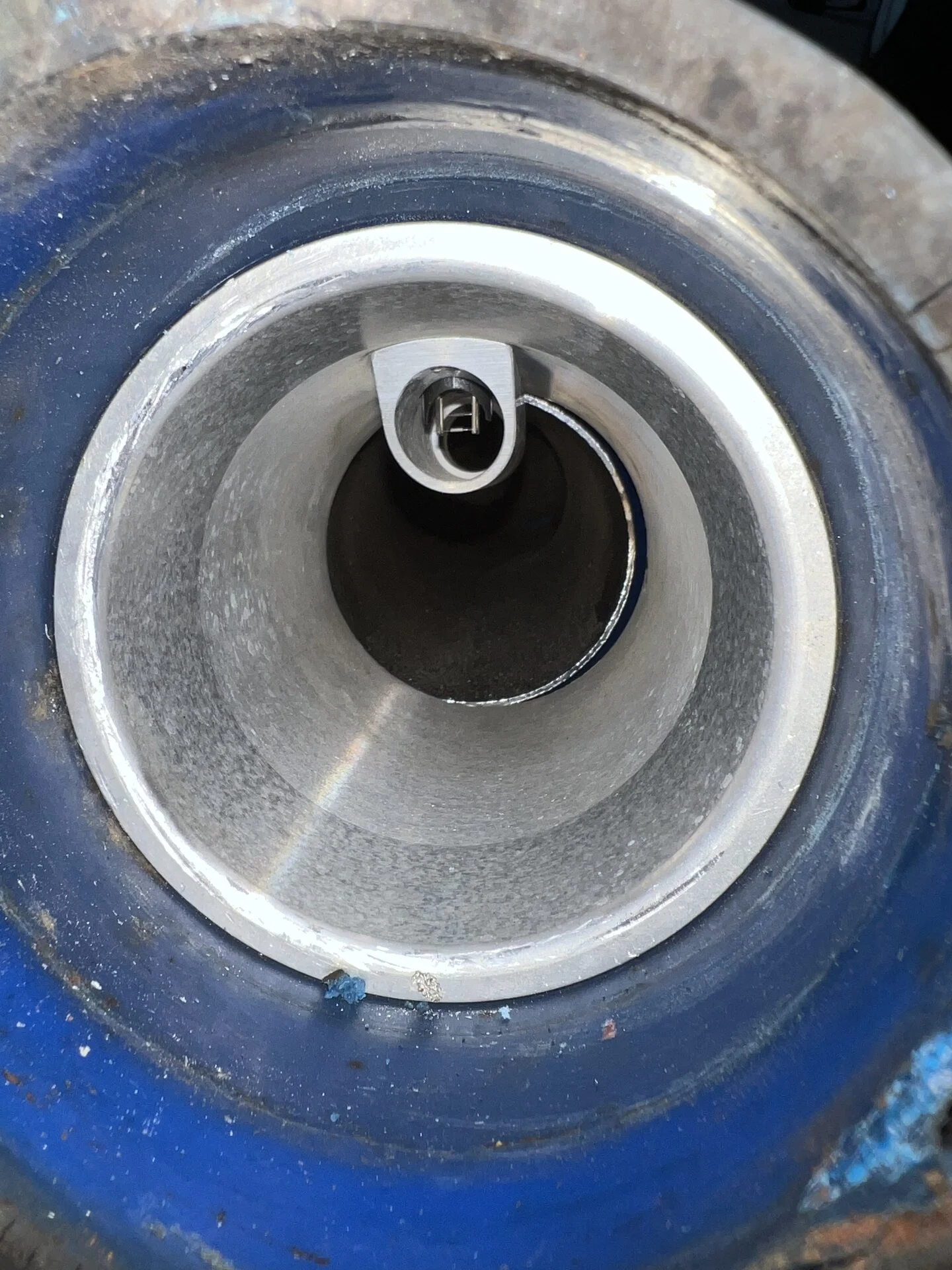

Am I looking at the right thing? What is supposed to be colored
You’re supposed to look at the little tube that the sensor element is setting in. It should have a blue paint marking on one end if it’s for 24lbs injectors. If there is no marking it’s the 19lbs tube.
Yup blue marking. Any chance it could be 30lbs since the car has a cobra intake ?
