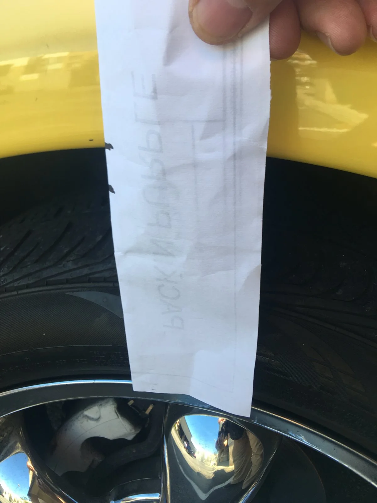

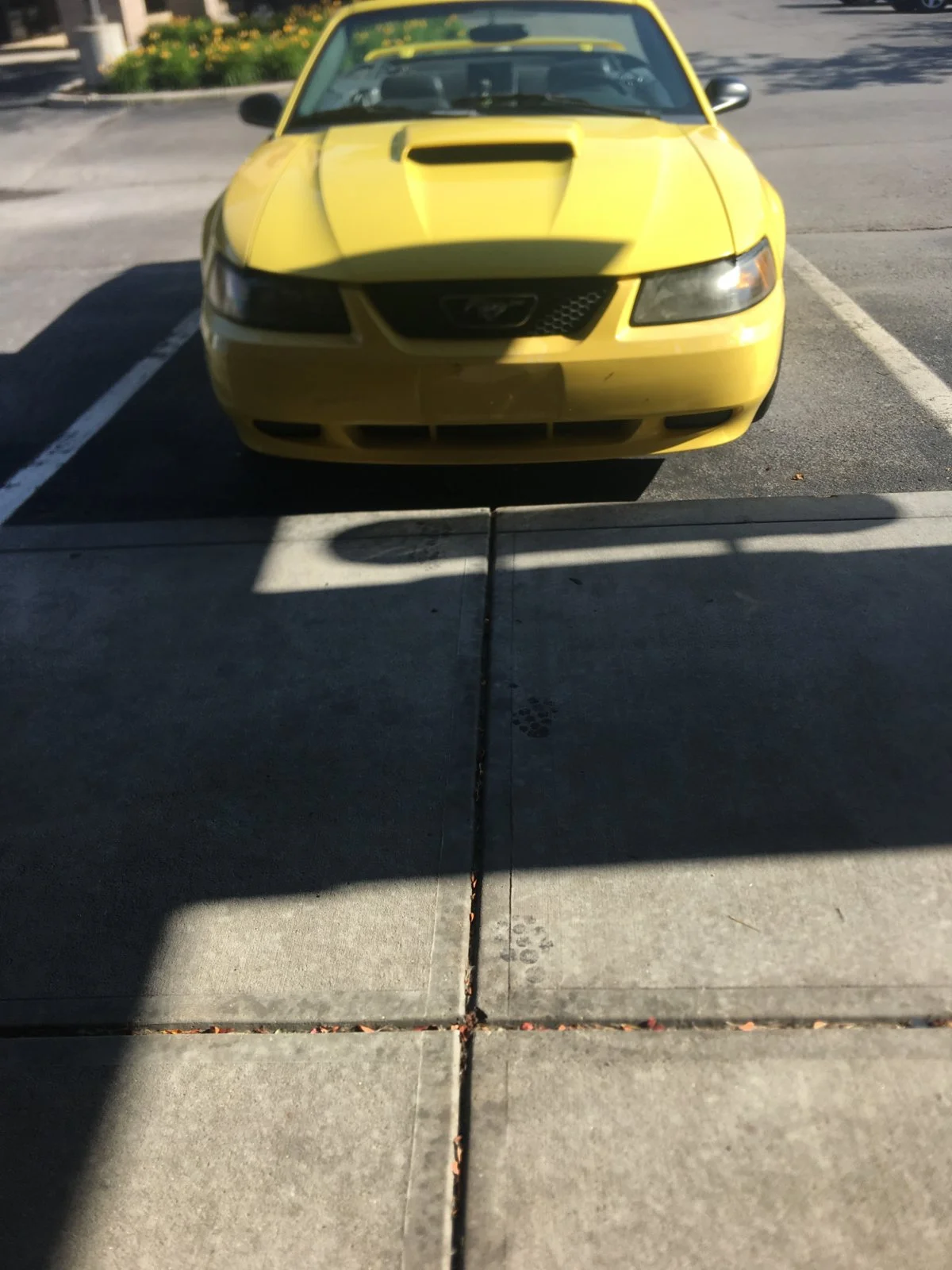

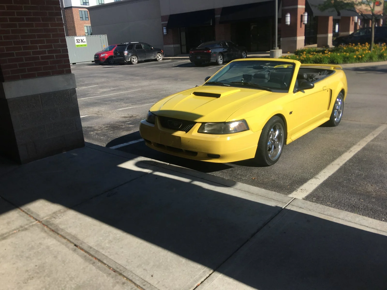

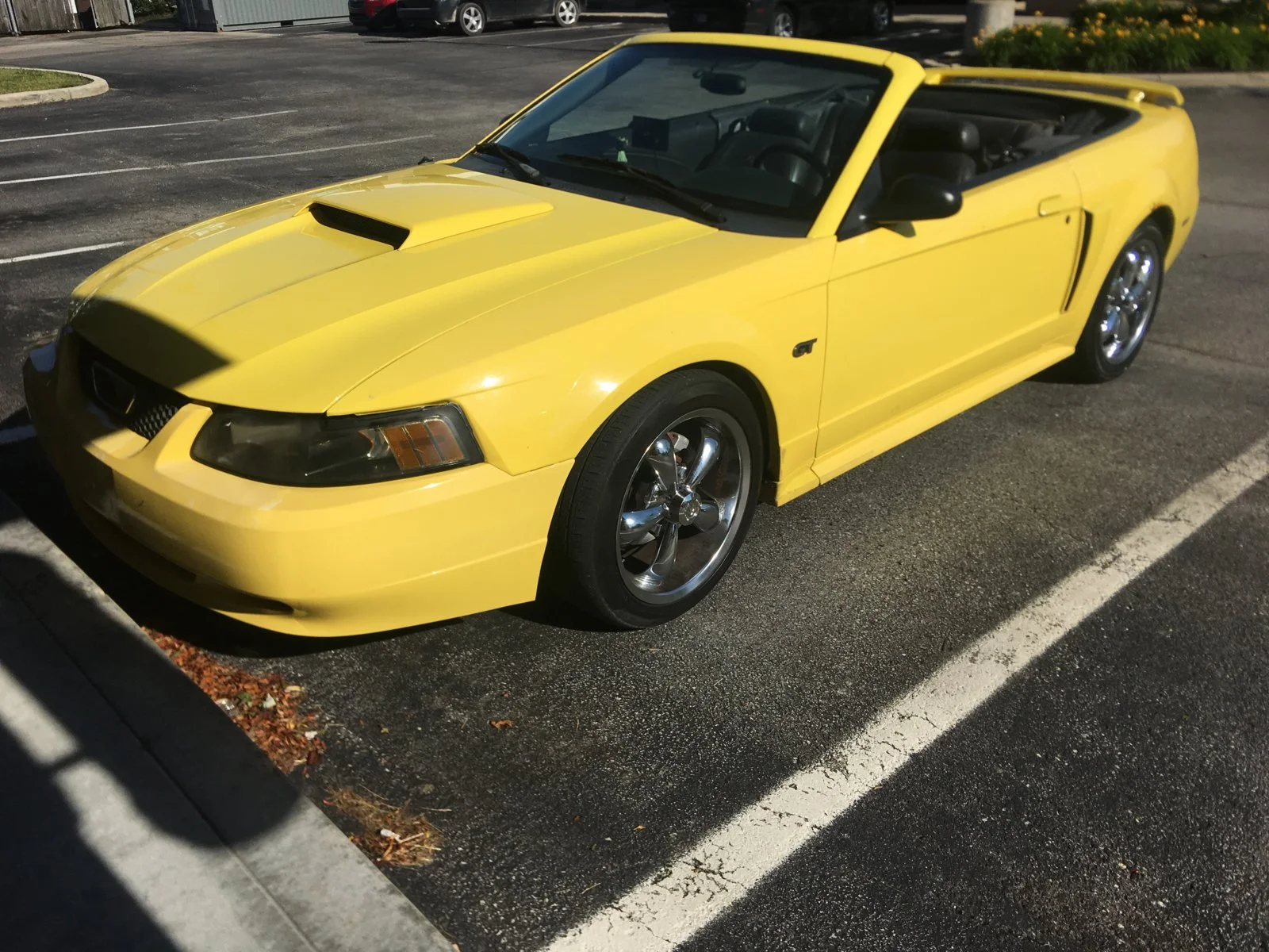

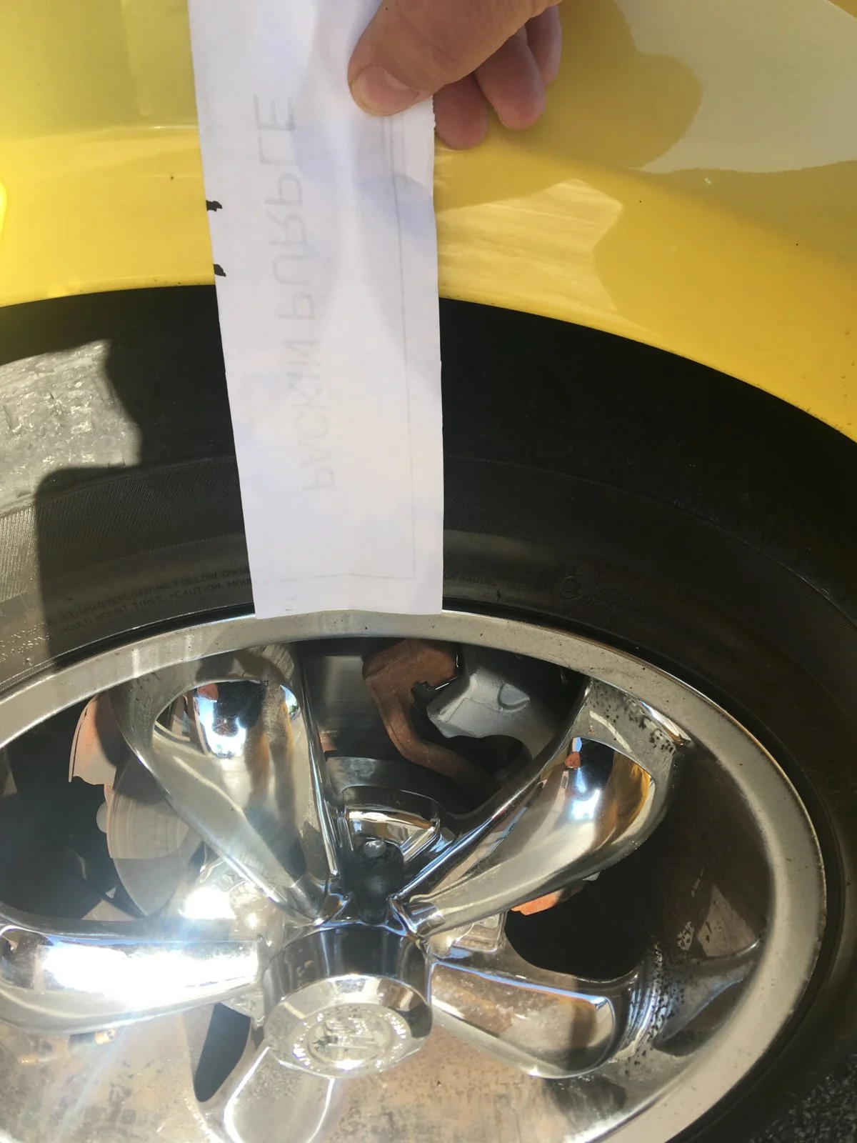

So I finally went out and measured both sides and, sure enough, the gap between the tire and fender is substantially shorter on the drivers
side. Thoughts? Struts? The car has stock suspension. Thanks
Assuming there is no prior body damage - I’d check that the tire pressure / wheels are exactly the same, that there is no weight in the passenger compartment / truck that would affect the ride height, and then I would park and measure in a different parking spot that was level. If the simple things check out - I’d check the front spring isolators and springs. Springs are the primary determinant of ride height.
My ride height was a little off recently - took my front suspension apart and replaced my spring isolators, they were 10 years old and literally crumbled in my hands as I took them out. Ride height fixed.
have you pulled the wheel off and inspected?
Given the car is almost 20 years ago, I wouldn't rule out a broken spring. Have seen them rust up and a coil snap given you an uneven height.
Struts don't really play a role in ride height
