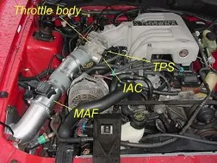

2. Locating the IAC valve:
Depending on the year of your Mustang the IAC can be in a few different locations.
- On 5.0L Fox body cars the IAC is bolted to the side of the throttle body.
- On SN-95 cars it is bolted to the intake manifold
- On 4.6L DOHC and SOHC engines the IAC is located on the upper intake manifold.

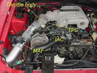

In reality once you know what one looks like (picture 2 "B" from a 94-95, fox body's have longer silver IACs) you should have no trouble finding yours. They all look basically the same except pre-94 cars were made of metal and are silver, 94-up cars are black plastic.
icture 1
3. Removing the IAC:
This part, like the rest of the steps in this article, is simple. The IAC has an electrical plug that needs to be disconnected (picture 2 "C") Then all you have to do is remove the two 8mm-5/16" bolts (Picture 2 "A") that hold the IAC to the throttle body or intake. Watch out for the IAC motor to throttle body gasket, don't lose it!
4. Cleaning:
Next all you do is use the carb cleaner to clean the carbon out of both of the holes (picture 3 "C") in the IAC valve and both of the holes in the intake/throttle body.

I bet it is probably your IAC valve.
If it has went bad get a OEM Motorcraft replacement IAC valve
don't get a off brand.A IAC is one part I would never go cheap on.
Also one or more of your fuel injectors could possibly be clogged.
If that is the case have your fuel injectors cleaned by hand.
