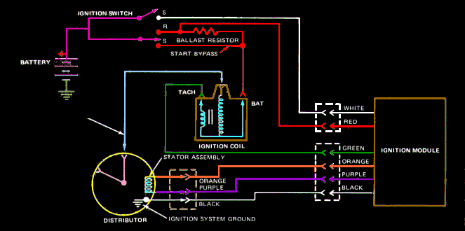

sharp2377 said:
I would except that is my only means of ignition. My distributor needs as box to run. MSD told me it would either work or not work and the 6al wouldn't cause sputtering, it just wouldnt run at all.
Duraspark II ignition diagram:
Diagram courtesy of /www.billwrigley.com
Note the ballast resistor shown in the diagram: you’ll need that too
See http://webpages.charter.net/1bad6t/duraspark.html for more help.

I dont have the duraspark setup. I only have the msd 6a, blaster 2 coil, and a Mallory mechanical advance distributor. My car was originally a 4 cylinder so none of the old ignition components were used.
