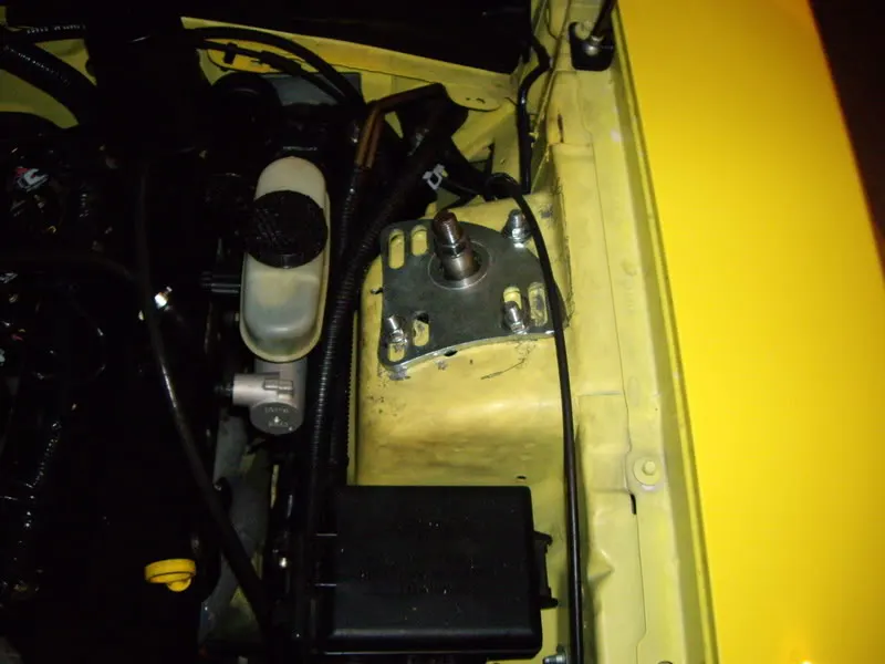

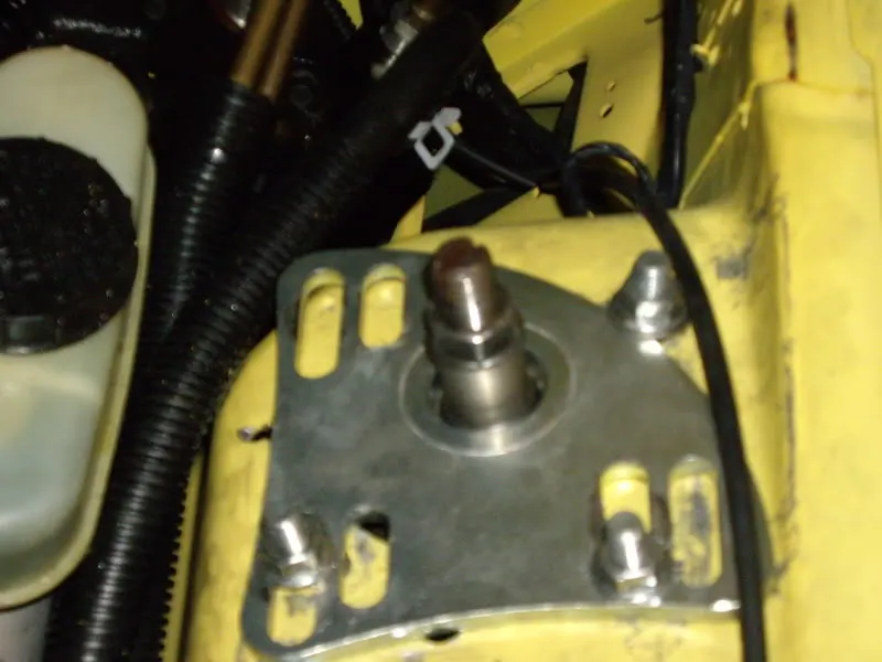

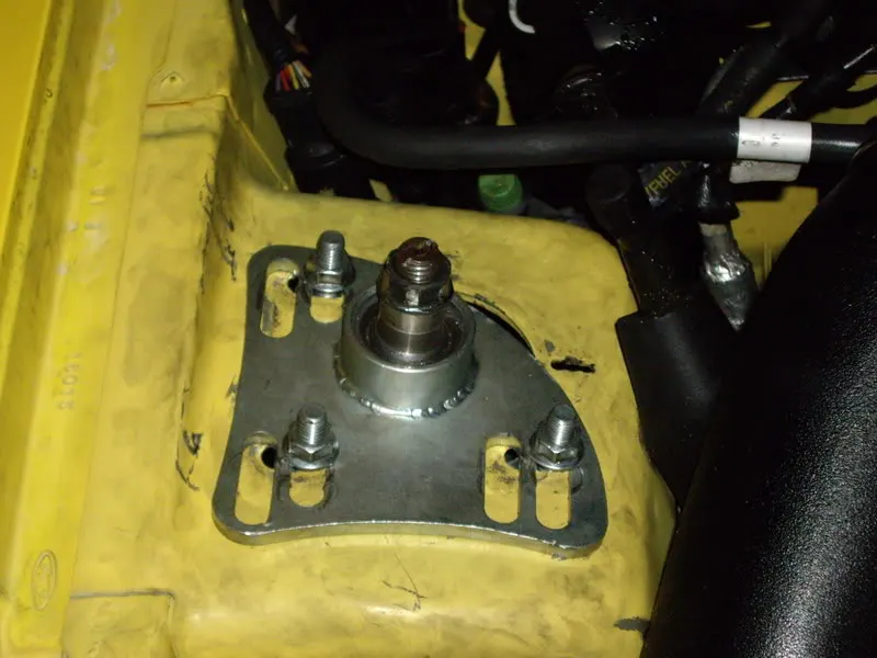

I didn't have the tools to install these correctly so I took them to Goodyear where my alignment was still under warranty. I picked it back up earlier and drove it for less than a mile when I started to hear thumping sounds under the hood. I went back to Goodyear, the mechanic added spacers, and now it seems ok BUT, he seemed unsure about what was going on and said I should come back and told me something about how my tires made it hard and some other stuff that I didn't quite think would make a big deal. Anyhow, the plates are installed but they don't look right so I'm attaching pics. They were obviously taken from the front end and it looks like the right hand side plate is upside down, or backwards, also notice the top right bolt is not even part of the plate...just holding it with a spacer! Either way something doesn't look right and if I go back in there tomorrow I'd like to be able to tell them what's up so that they can fix it!

The spacers on the struts are normal but the CC plate on the right is upside down. I'd get the manager in on this one.
i had the upr 4 bolt c/c plates and they were the ****zle. mm ones are bad ass too. i would try and get those guys to do something about their screw up. also, are those just slapped right onto the strut towers? i don't know about the "shark" plates, but aren't there supposed to be spacers under the top plates like on the 4 bolt ones or other brands?
1. Do NOT drive that car anyplace other than going back to those butchers and demanding they fix it.
That guy must have had meat hooks for hands and sh** for brains.
The plates look very flimsy BTW.

Flip the plate around and drive it back to the shop to get it re-alinged.

Well I went back there this morning, told them it was unacceptable and that I didn't quite understand how a mechanic could've done something like this. The guy tried to tell me that I took that risk when I gave them an after market part, which is crap, and then said that the scratches around that area were normal. He didn't have much to say about a stripped bolt or the fact that my driver pate was held in place partially by a bolt w/ a washer under it. I got my money back and hopefully the plate wasn't flipped to try and hide something...
