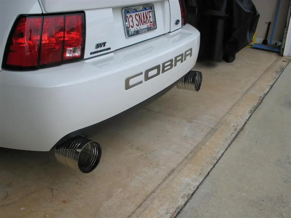

I think my Magnaflows have 3.5 in tips. :scratch: They fill up the bumper cutouts quite well.
You could always go for the 3lb coffee can tips if you really want to impress the ricers. That's what I do when I go out cruising.... :rlaugh:
