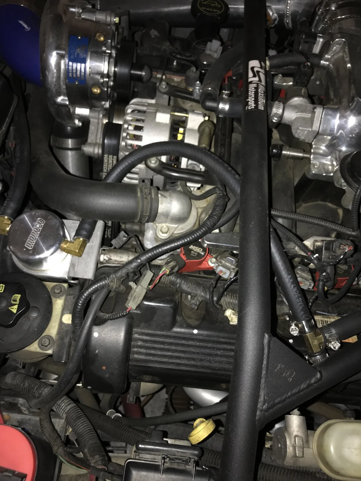

Moroso’s kit is great. Love the position on the front of the engine and easy emptying valve on the bottom of the can. Have a blow thru setup so my crankcase is no longer connected to the air intake. Crankcases dislike boost. :D
Both valve covers have tubing that comes to a T (brass T in picture) feeding the can. Outlet of can has a hose that feeds in to the fender next to the air intake cone filter. Smell is gone. :nice:
Since you are still NA - similar setup but you can connect the can outlet to your intake to take advantage of the vacuum (but now with no oil in your intake!).

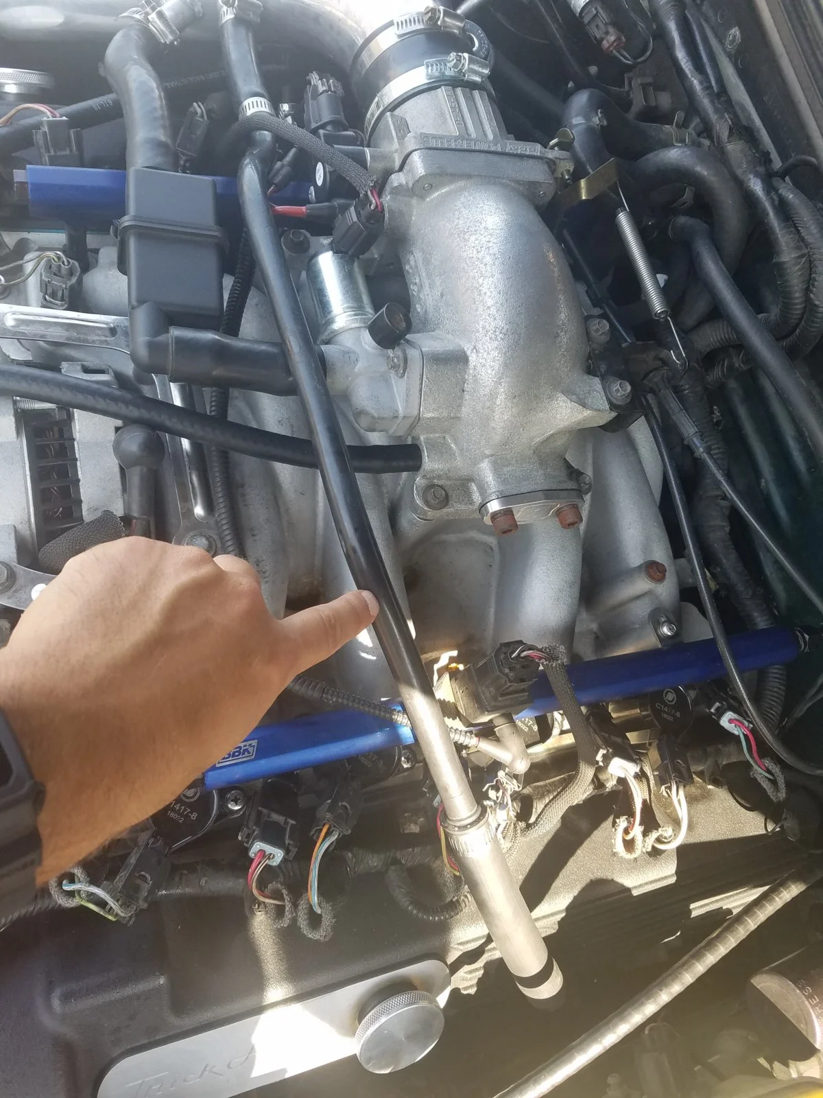

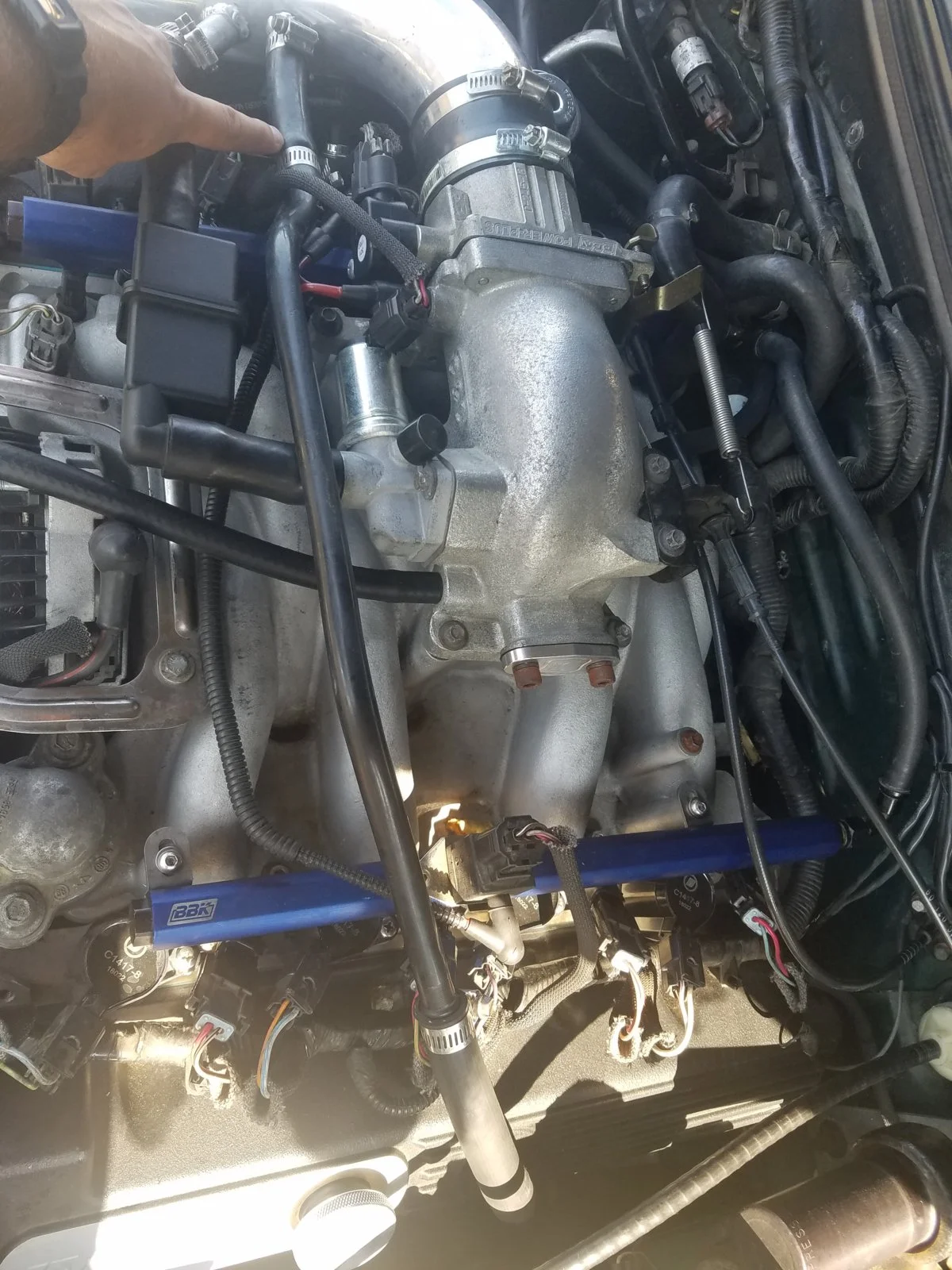

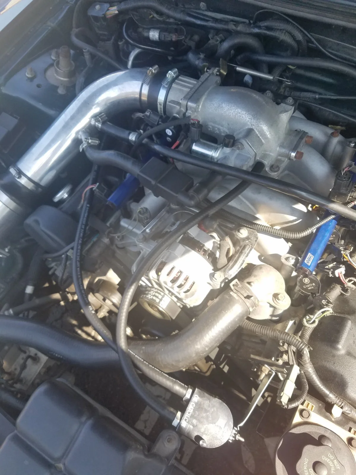

I ran the catch can from the IAC to the pcv valve like you said. I attached a picture to show how I ran it. I've also attached two pictures showing the driver side valve cover jetting a hose over to the cold air intake as well. I'm assuming this is part of the vacuum system. Is there anything I can do for that to prevent blow by on that side of the motor. I can't just put a breather on that one can I and cap off the air intake port? Just curious as I want it to be clean inside the throttle body so if i can do something with that I will.

You have vacuum so that “clean air side” tube brings clean air in at idle to the driver side (less vacuum here) while the PCV on the passenger side pulls the air out under vacuum (more vacuum here makes this mostly a one way system). Drive around for a gas tank or two - check your oil catch can and check that “clean air side” tube. You should have a little crud in the oil catch can and a dry clean air side tube. If that is the case you are good.
