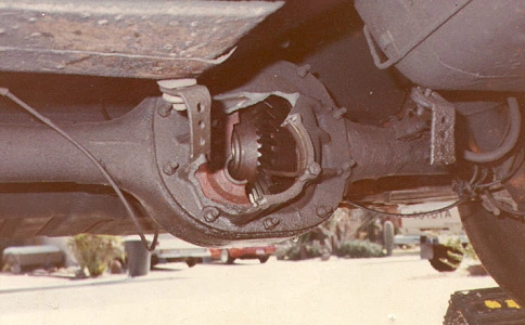

BTW, I broke an FMX in two...

That FMX looks like maybe the transmission mount was loose, with the way it broke off at the tailshaft housing /main case junction. In that case, it wouldn't have been a design flaw/weakness, just poor maintenence
