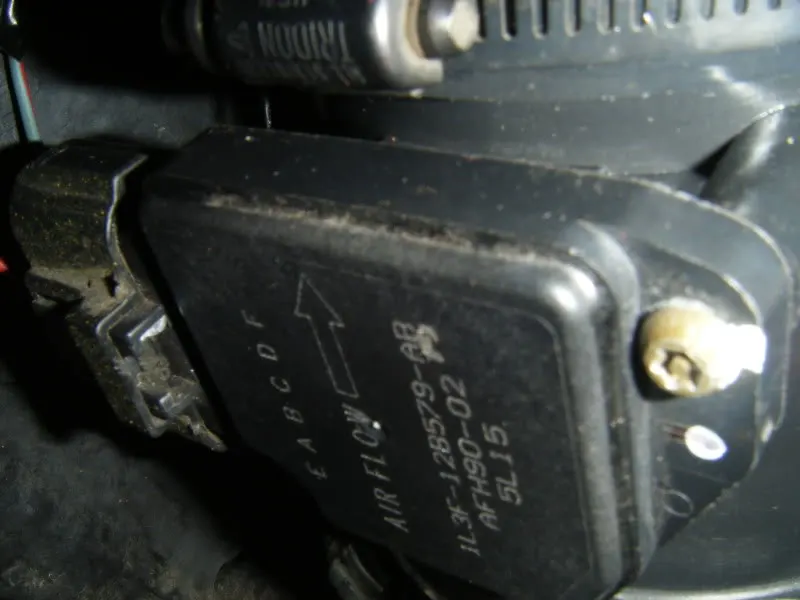

I swapped out my pro M for a lightning meeter.

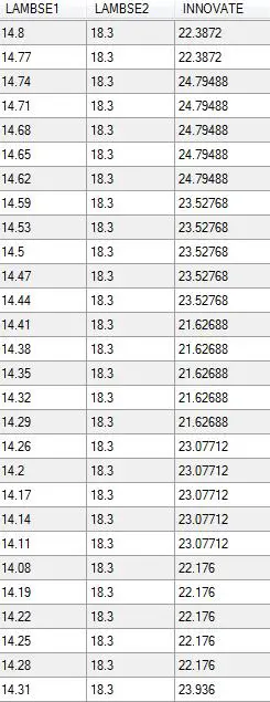

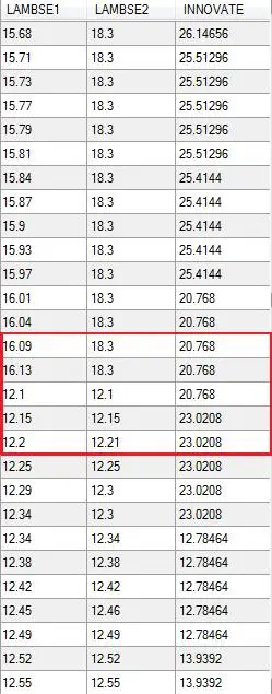

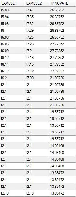

now im having an issue in CL under light or closed throttle. The car will go extremely lean and max out the wide band. If i depress the clutch and blip the throttle the car goes back to a normal AFR. However if i try to give it gas in gear it will normally backfire through the intake. It will also do this initially when pulling up to a light and starting to idle but will then smooth out. During the times this is occurring the Lambse value will be way off of the value of my Wideband.
The other issues i was having went away when i switched to a 90mm Lightning maf and the stock injector values from a J4J1. The car runs great at wot and cruses at 15.5-16.5 with an occasional spike of 17. wot's 12.5-13 until i let off then it goes to high 11's for a second or 2.
Thanks again for the help guys.

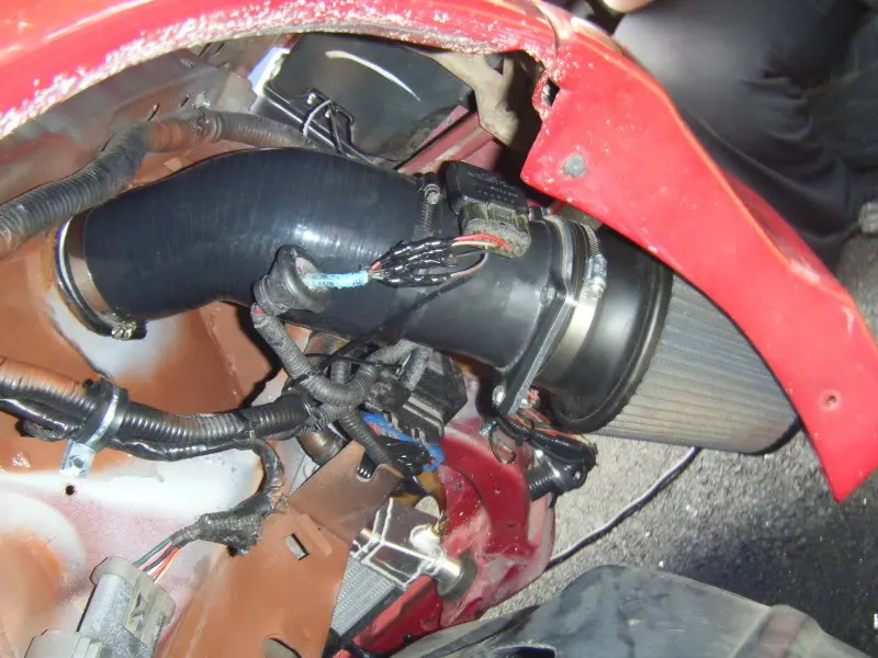

Yea... Im confident this curve for the Lmaf is spot on. The car feels great it just acts up down low in CL. In order to hook up the stock maf i need to find the correct reducers/adapters and cut off the pigtail i just wired in.
