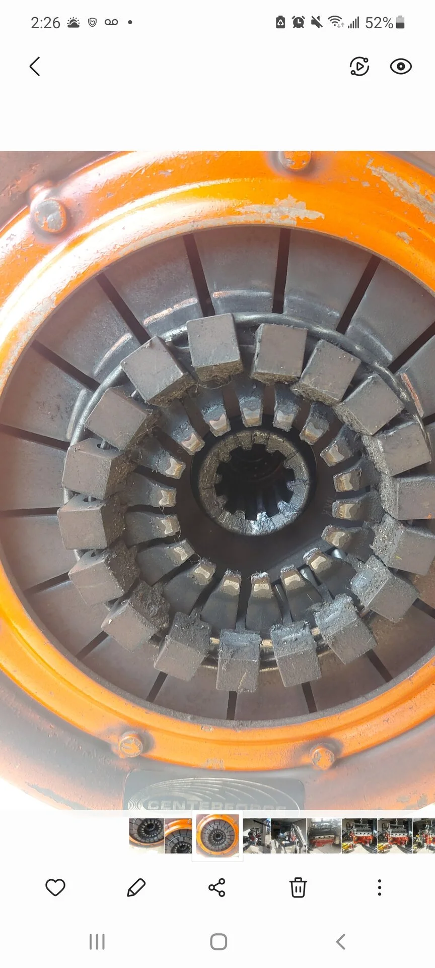

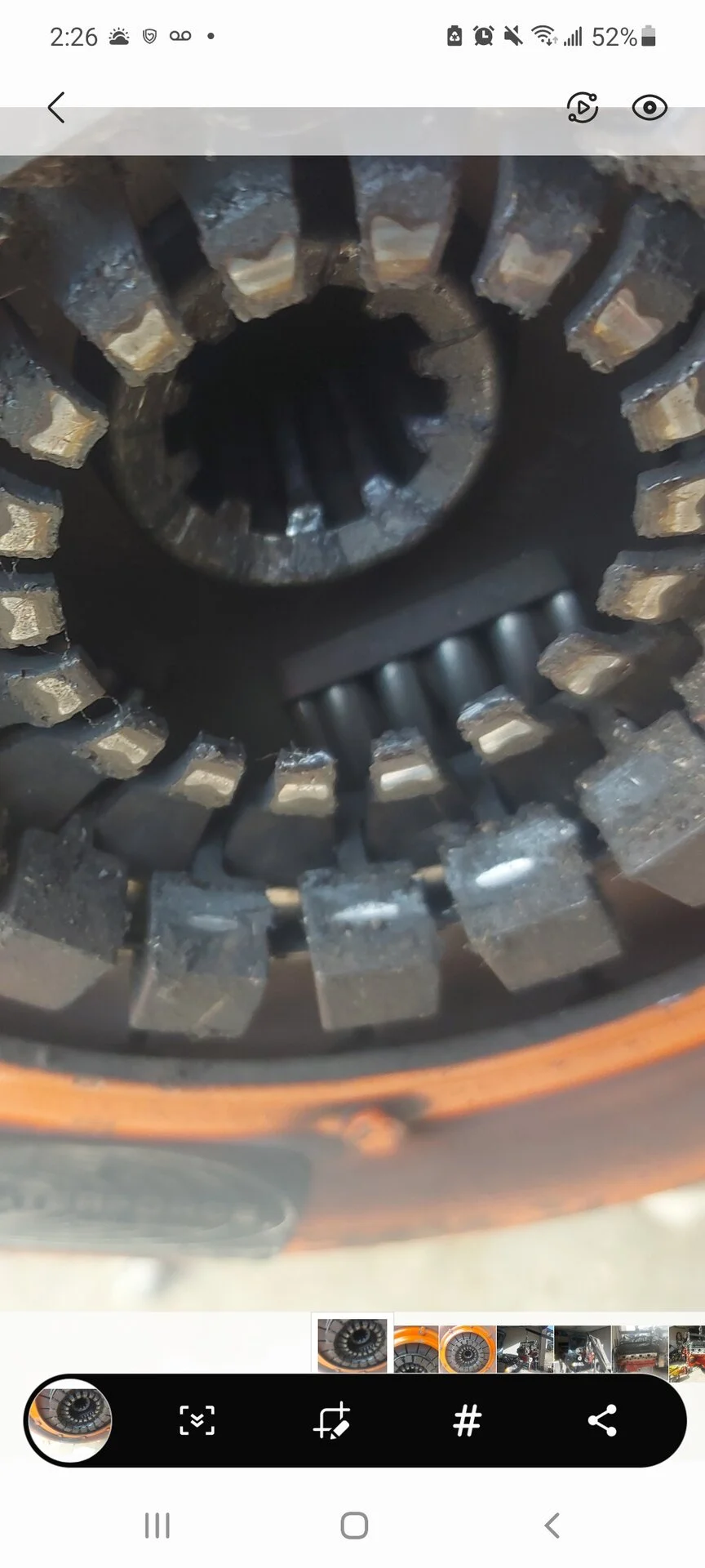

Hey guys so I pulled my engine I had a vibration at higher rpm... so I was having a look at the clutch and I belive it's not functioning correctly and maybe staying out of balance... I've attached some photos... is the pressure plate ****? Can it be fixed? There is clearly some uneven wear hereq

Yea not helpful run them for 15 years and never had a issue till now this is a 300hp 5.0 dude spending money doesn't always solve problems and factory clutches worked great for the application I'm looking for a cause
If the input shaft isn't sitting correctly it can cause a vibration and uneven wear. The bellhousing and block surfaces have to be smooth and flat. The run out also should be checked to make sure the input shaft and clutch friction plate are centered correctly.
Also, make sure there was no oil leaking past the flywheel bolts. Oil on a clutch will make it do some weird stuff.
The drive shaft could need u joints and balancing, get it checked while it's out.
Personally I don't see a big issue with that wear, a throw out bearing that does not fit the trans retainer could cause that (side load, cheap bearing or worn retainer on trans)
you replacing the clutch?
Wasn't planning on it... it does this is every gear including N drive shaft is good only thing I haven't tried is running it without the belt on
