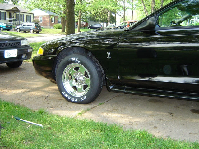

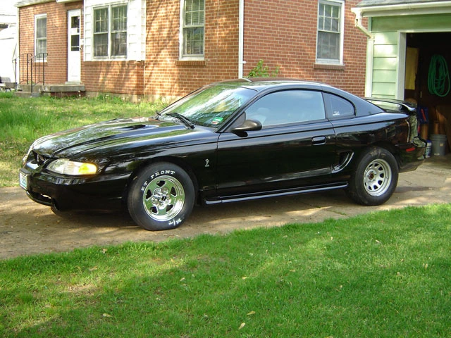

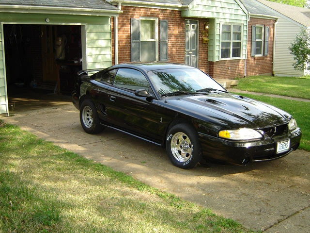

Wow, they look good...and they don't stick out as far as I thought they would...I think I may have to spring for the rears soon because these rims are sweet looking...
And for the tech part:
I used H&R 30mm spacers and they pretty much bolted right up...The only thing I had to do is cut off about 1/2" from the tips of my stock lug studs since they stuck through the front of the spacer...Other than that, no grinding needed whatsoever and I can still used my stock lug nuts with these wheels since they take the acorn style conical taper nugs...
