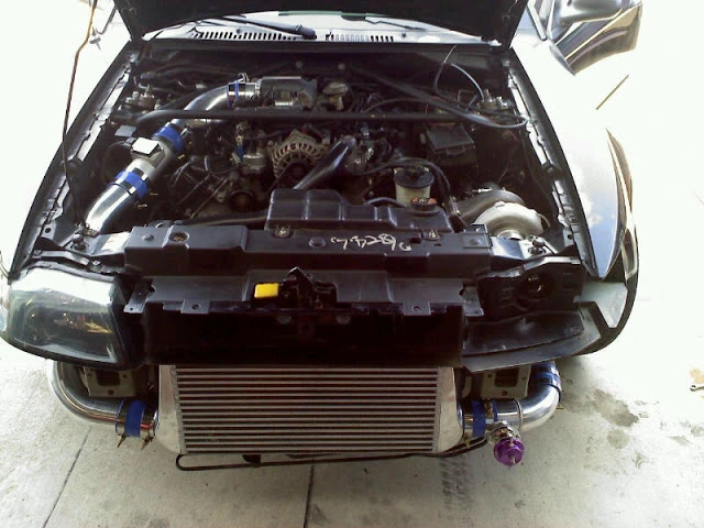

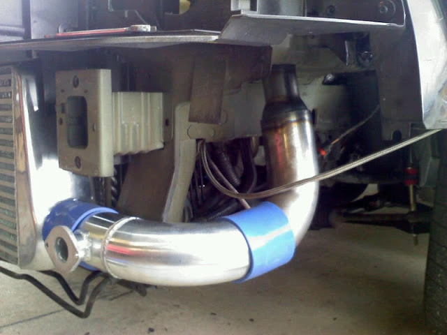

If you get a flange style like mine you will have to weld it in. As what mark posted turbo smart makes a great BOV thats clamp style like the your stocker. There are two types of BOV adjustable and non-adjustable. Most non-adjustables have a set spring inside to open up at a level of vacuum. Stiffer springs for a lot of vacuum and softer for not a lot. And since you have cams make sure you get the softer spring version or adjustable version.

Custom built by my brother and I
http://www.stangnet.com/mustang-forums/813965-tank_567-turbo-build.html
