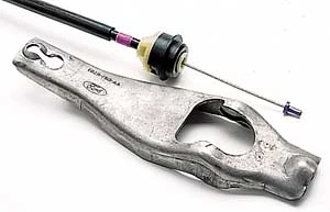

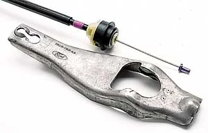

Go here http://www.jegs.com/cgi-bin/ncommerce3/ProductDisplay?prrfnbr=3221&prmenbr=361 and get this.
The best deal you will find for a stock "Factory" cable and a new heavy duty clutch fork!
