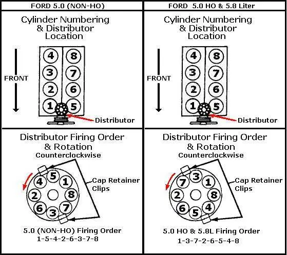

Maybe this can help...

no i did not, but i removed each wire and plug one at a time to ensure no confusion with the firing order. i manually screwed them in by hand then tightened them down with the socket/ratchet. i just ordered some accel 8.5mm to replace my 9mm ford racing ones. they looked kinda old, but if that doesnt correct the issue than i am just going to buy ngk v powers again and put them in.
