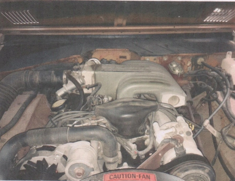

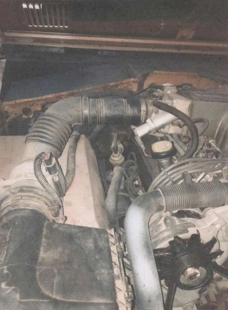

I do know of one gear ratio easily available for T-5s other than the usual used by Ford, but unfortunately it is only for 5th. gear (overdrive). That was used by Jeep in T-5s mated to small Dana Transfer Cases I believe in the early '90s. Used those Jeep gears when I built my '70 Bronco w/ 5.0HO and T-5. Here's the look underhood:
The metal can connecting the Mustang rubber inlet duct to the TB was chosen for size by measuring foodstuffs in a big supermarket! Below, the truck before I gave it to my nephew, who restored the body.
