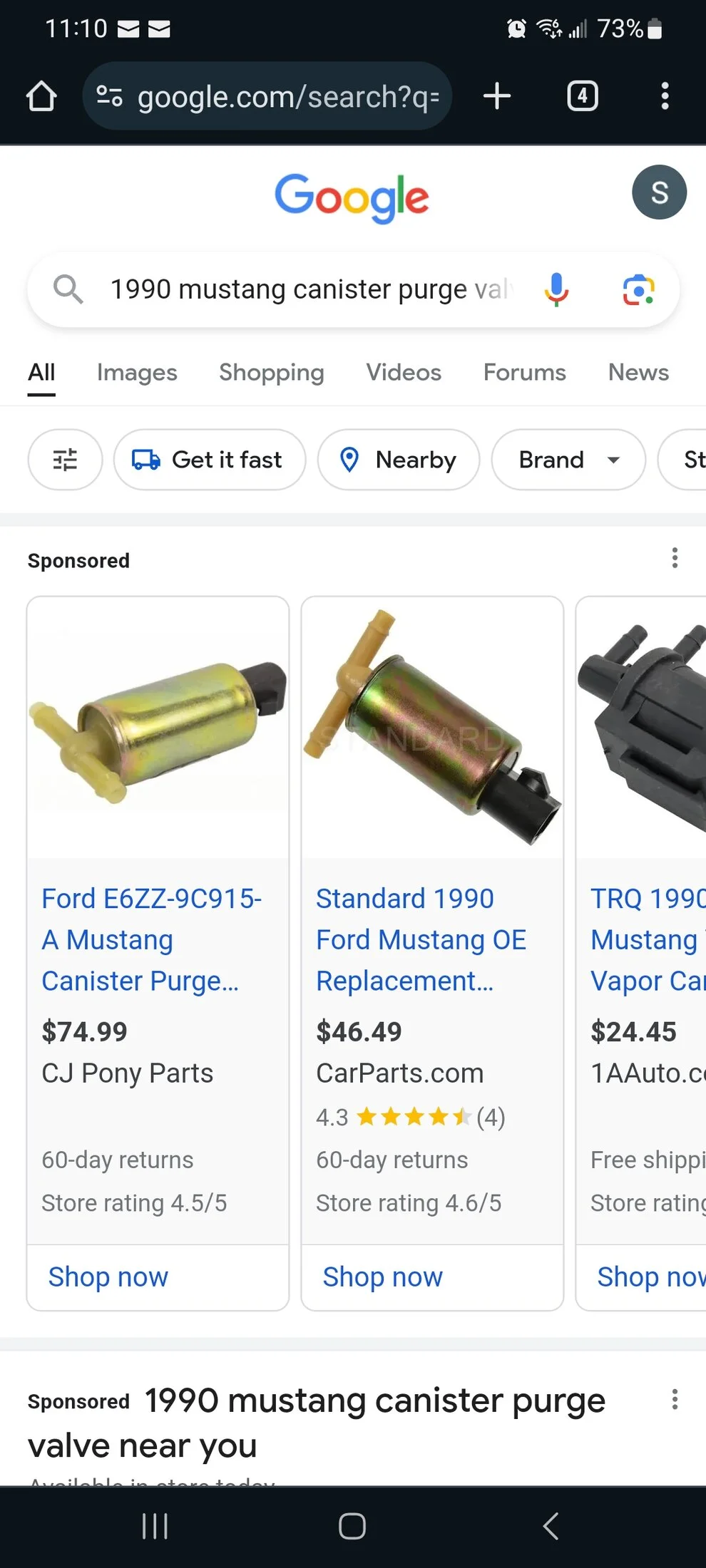

A good one way check valve will work to keep boost from going un the canister. There should be a solenoid on that vacuum line. I don't remember if the solenoid is usually open or closed.
So I'm slow sometimes ...in also installing a Terminator X system so the stock solenoid will be no more....
Do I just let the canister vent to atmosphere, delete it, or use a check valve?
@Mustang5L5 any input? ....
I've done some reading and I take it I don't want almost constant vacuum on the canister/tank due to how the stock solenoid pulses...
I don't really care about the gas smell potential but if the canister vented to atmosphere will help that I'll leave it.
Or will the canister get clogged up with a vac source to evacuate it?
