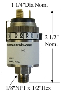

If you were very crafty, you could rig up a vacuum controlled switch that powered the solenoid only within a specified range of vacuum,. That would be somewhere in the range of 7"-15" or whatever vacuum the engine pulls at cruse.
The plumbing is no big deal. That the valve opens at certain times, rather than it is open when the motor is on, is what I needed to know first.
Any ideas where to get such a vac operated switch? Would a turbo specialist have access to an adjustable vac switch? Maybe a diesel or water injection system place? If I had an OEM lead I could get one, but it is not ringing any bells?
Google is your friend...https://www.google.com/?gws_rd=ssl#q=adjustable+vacuum+operated+switch
http://whitmancontrols.com/ecatalog/Vacuum-Switches/J205V-1S-C12TB-DIS
http://www.plccenter.com/en-US/Buy/WHITMAN CONTROLS/P117V3HK12TS
Or
http://www.designflexswitches.com/switches/psf109s.php
