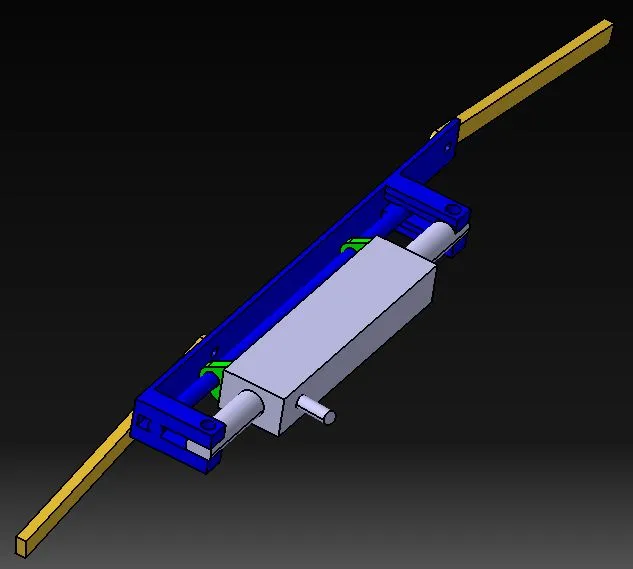

i designed a rack for my falcon after being disappointed with the TCP i put in my drag car, 65 mustang. I lost a little turning radius and i spent a lot. I believe its a great quality rack, best that you can buy and bolt in. I acutally gained a little weight as well. so that was disappointing.
but there is no OEM rack out there that will have the same travel as a stock mustang.
i decided to go with a Appleton or Woodward rack. Both are aluminum housings and any ratio is available. with a little bit of searching the racks can be found for around $400 (manual). that is cheap for an awesome rack. The actual racks on OEM are very small in comparison to one of these or woodwards/appleton. THe first TCP rack was a woodward rack and pinion. Now TCP just uses the Pinion and servo.
For my falcon, its going to be a handling car. I already custom designed and fabricated my suspension. i went with a manual stlye rack, here is a pic.

You might want to re-think your design a bit since Appleton and Woodward circle track racks are front steer and your design looks like you plan to use the rack in a rear steer setup, like your original falcon suspension. It might work I guess, but when you turn your sterring wheel to the right, your car will go to the left! Hey, that might be fun. DO IT!
Woodward offers a front mount right hand drive rack that can flipped over for left hand drive rear steer.
thanks rhino9 at least someone knows whats available out there.

I am new also, i see thats your first post, welcome. just wanted to let you know, I have already talked with engineers at these companies. they have a rack that will work for my set-up. I appreciate your concern.
