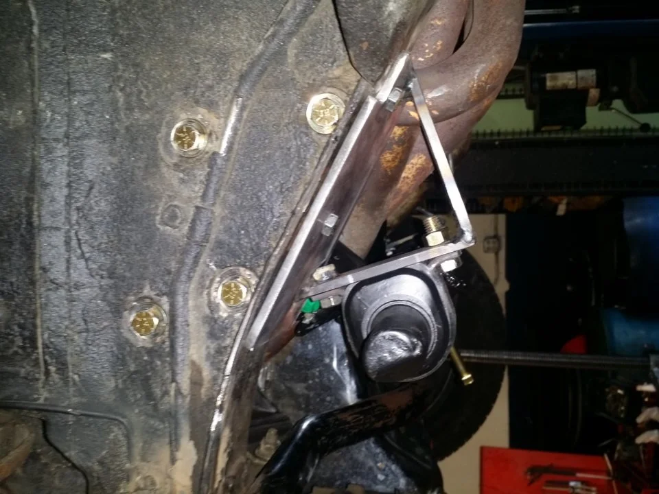

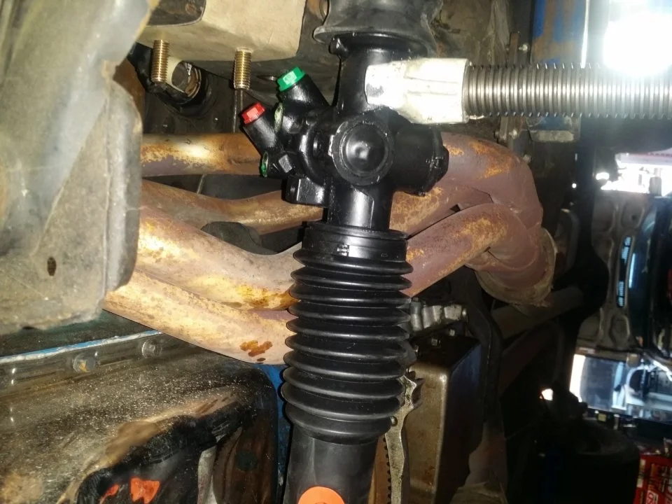

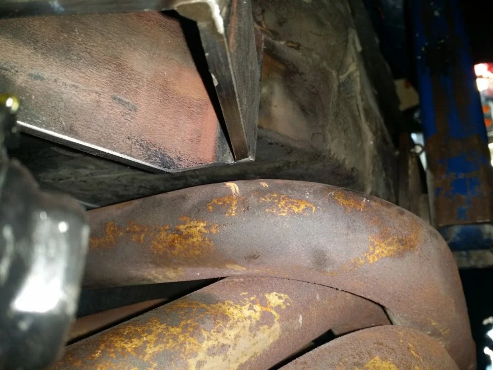

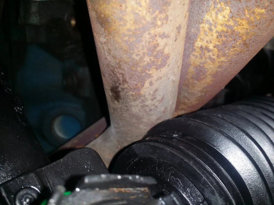

Hi I have a 69 mustang and was using this thread for my swap. I am using the rack and pinion the OP is using.

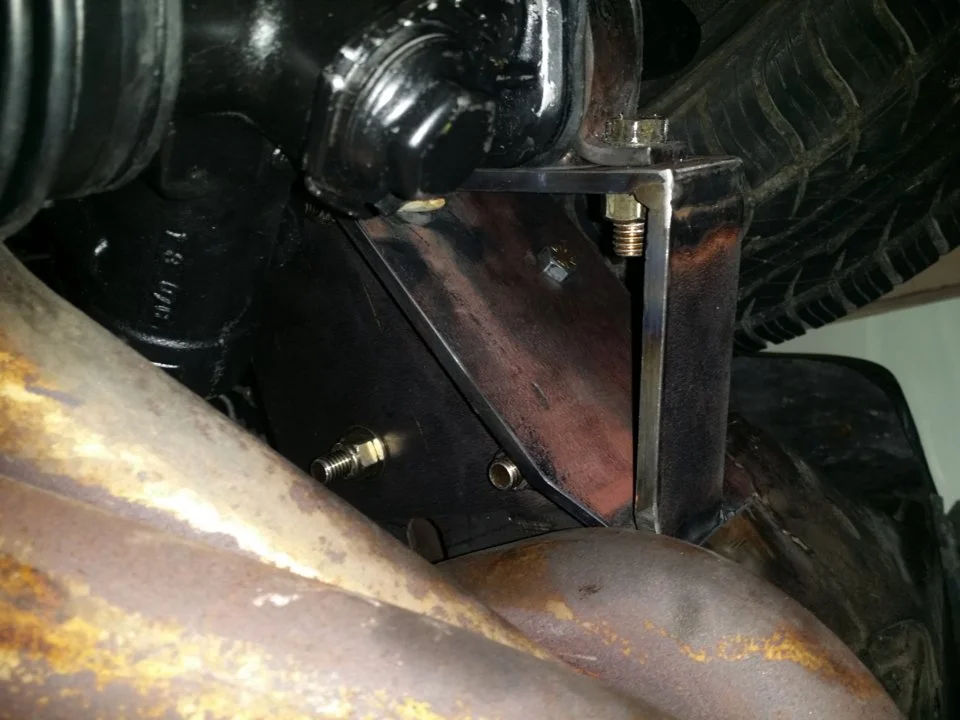

I'm having some issues with the R&P hitting the drivers side header. Unsure if stock or aftermarket
. 1420305218188.webp 1420305280873.webp 1420305218188.webp 1420305280873.webp 1420305336166.webp 1420305218188.webp 1420305280873.webp 1420305336166.webp 1420305381913.webp
Should I bend the header to get clearance and wrap them? Bring the R&P down some?
Any help would be appreciated.
Thank you, Josh

Josh, I think what you need to do is remove the header and get the R&P setup properly so that all the angles that the steering components are working form are proper. At that point you can take a torch to the headers and heat the hell out of them so you can gently bend them into position so they fit where they are supposed to. It might take a few test fits but if they are close enough you should be able to finagle it in place.

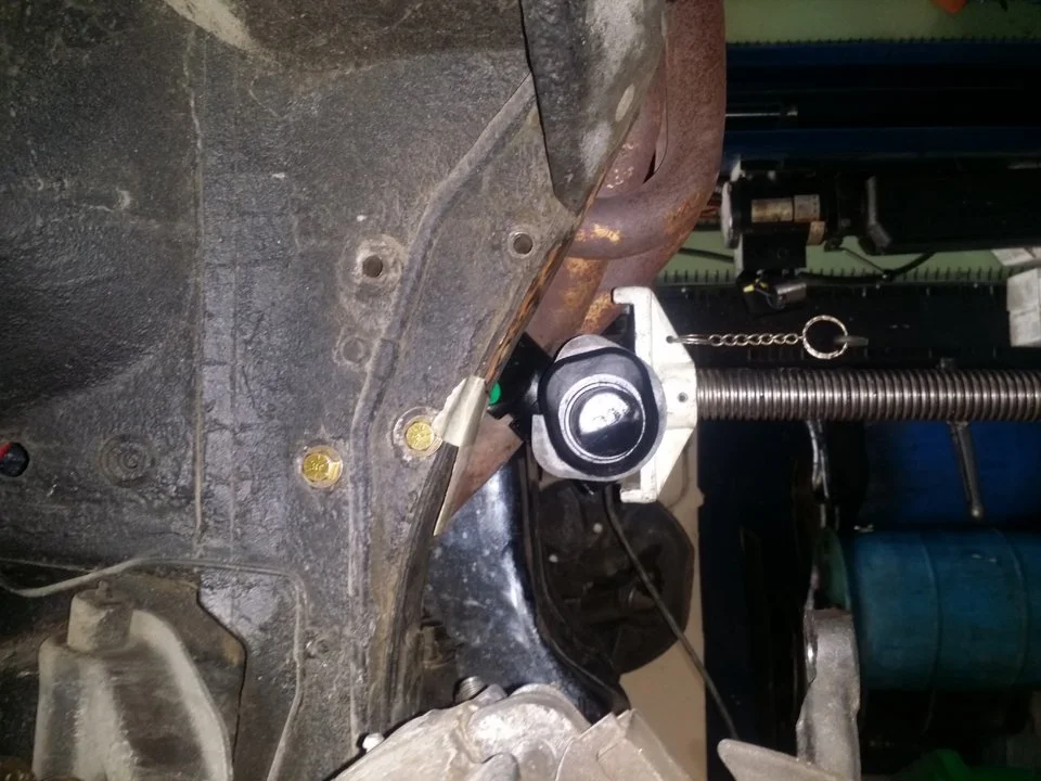

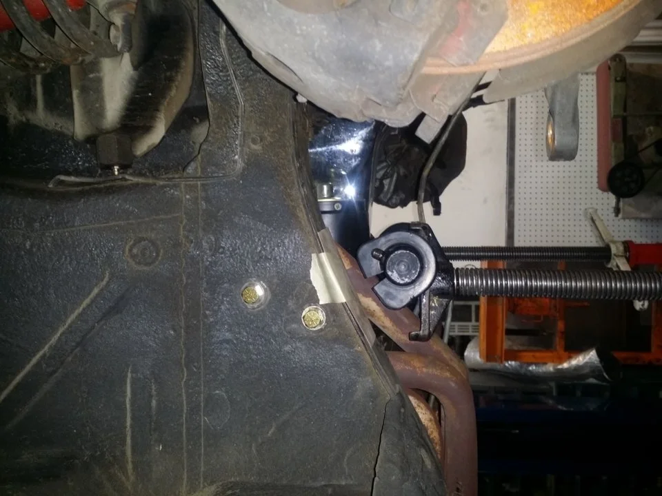

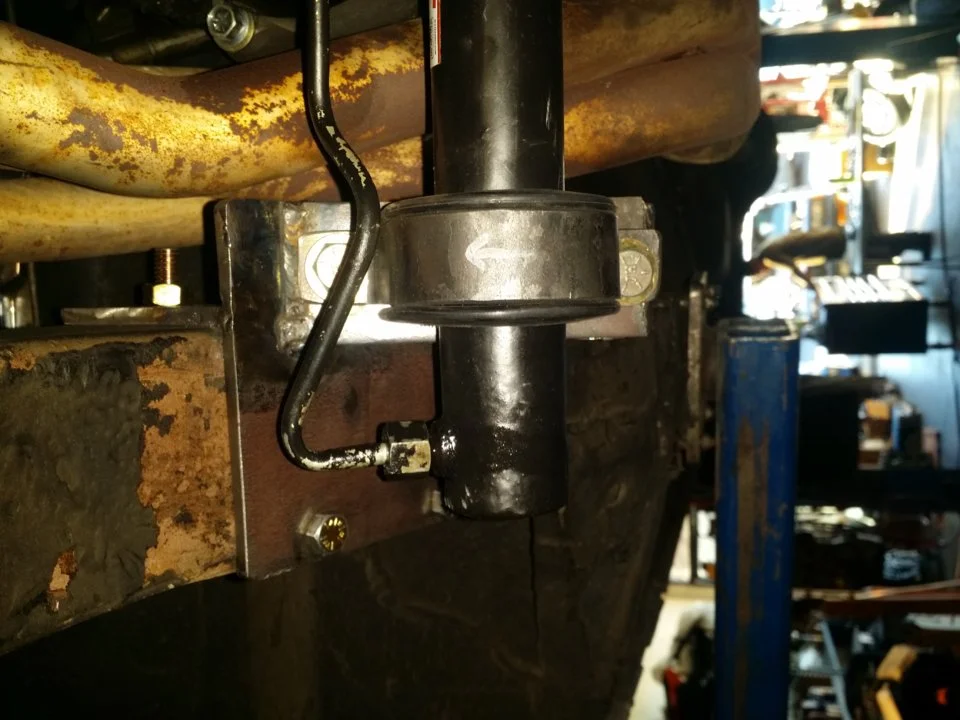

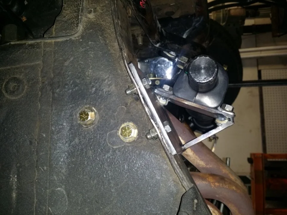

This is almost done. Just need to make new tie rods and basically that's it. Need little dumb stuff but its coming along.
