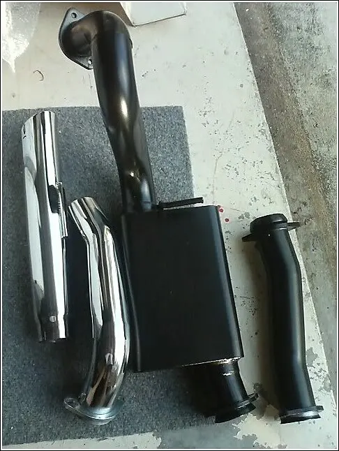

On my 94GT alone I bought MAC Equal Length in chrome-discolored and chipped over time, MAC Long Tubes Coated-discolored and chipped over time, last set was MAC Long Tubes Ceramic Coated and OMG they were so nice it was ashame they would be hidden. They never discolored and coating was amazing. Stick with the JBA or quality brand shorties if that's what you want. the S.S. will discolor over time. Make sure they are ceramic coated. Don't expect huge gains from shorties though. Long tubes is where it's at.
Pictures below of my last set up. Pretty much over kill but this was on a 347 with AFR heads. I also has this set up in 1-5/8" Long Tubes with 2.5" Collector, 2.5" MAC Prochamber, 2.5" MAC Cat Back with the stock 302 with bolt on's (aluminum heads, cam, intake, etc.) and Vortech Supercharger.
MAC 1-3/4" Long Tubes Ceramic Coated w/ 3" Collector
MAC Prochamber-The sound is ridiculous, I also had this in 2.5" for shorty heads which sounded great.
MAC 3" Cat Back w/ Chrome 3" Tips-The sound was simply sick.
