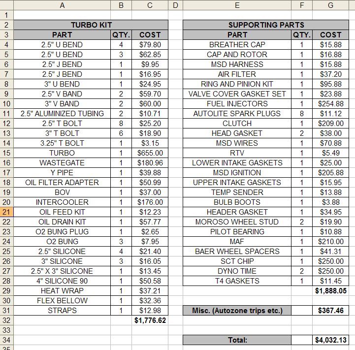

You really have no idea how much money you will need. This is assuming that you don't want to build some rigged POS.
This is from my 3 months of turbo purchasing. It adds up, especially the trips for little crap that you need. I nust have over about 50 receipts.
Some of these things might not apply, but I tink it is missing some things, such as autometer guages.

Now let me see your $1200 list..??
Oh yeah thats right.
NOT POSSIBLE!

Thanks for the list, but quite a few things on there I already have, or won't need replacing. The motor will be basically an already rebuilt mostly stock motor.
All pipeing will be a SMALL fraction of what you payed for yours. Where did you get a BOV for $37.00? DSM? I'll only need a couple things from the right side of your list. Can you link me to oil drain kit and oil feed kit?

Rio has posted the list I was going to there you have it. I guess either way it wouldn't be a bad idea to go into a turbo build being able to spend 4 grand. I am definitely not saying you would need to spend that much, but just so you don't get screwed running out of money.
