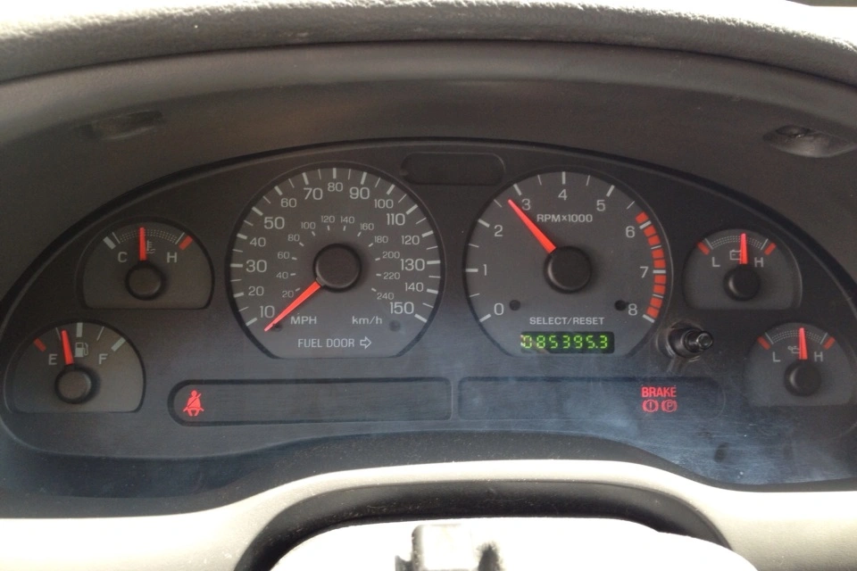

I'm trying to "legally" smog my car because it's the cheaper route for me. I'm keeping the car for myself. I replaced the bulb and checked the fuses, still no "service engine soon" light when I turn the key...? The cluster was replaced before me, do you think maybe it's the wrong cluster and that's why the computer can't recognize it? Could that be possible?

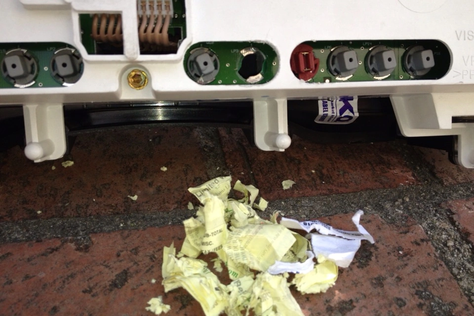

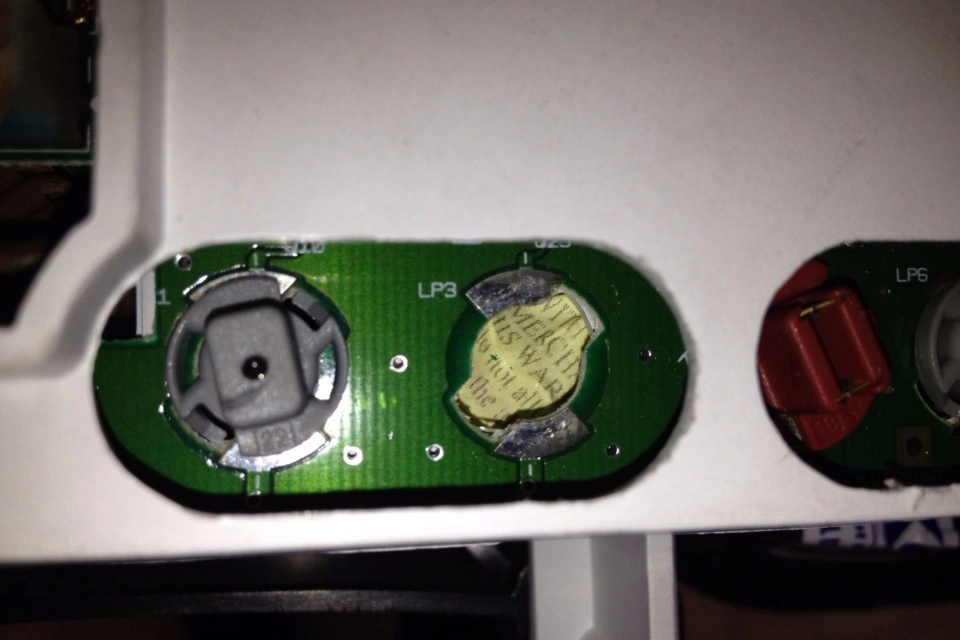

Oh sorry, forgot to post the update. The SES light comes on now and shuts off as it's supposed to. I found out the guy had put paper in the bulb socket so the light wouldn't come on.
