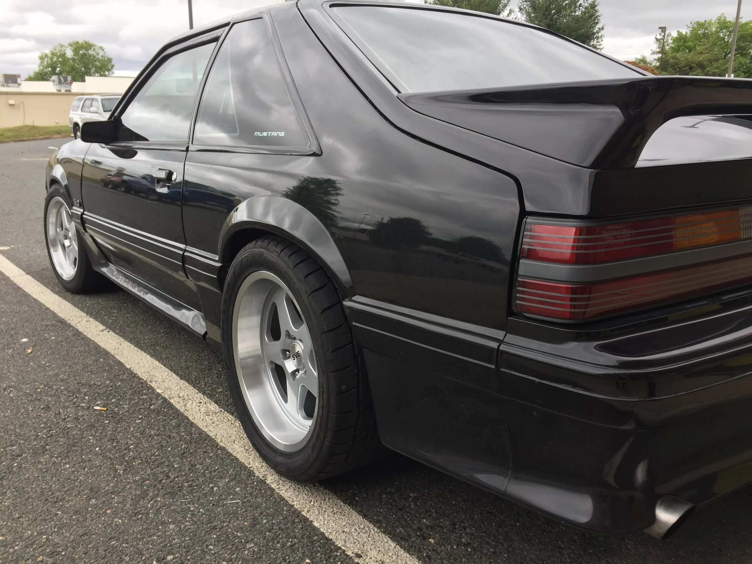

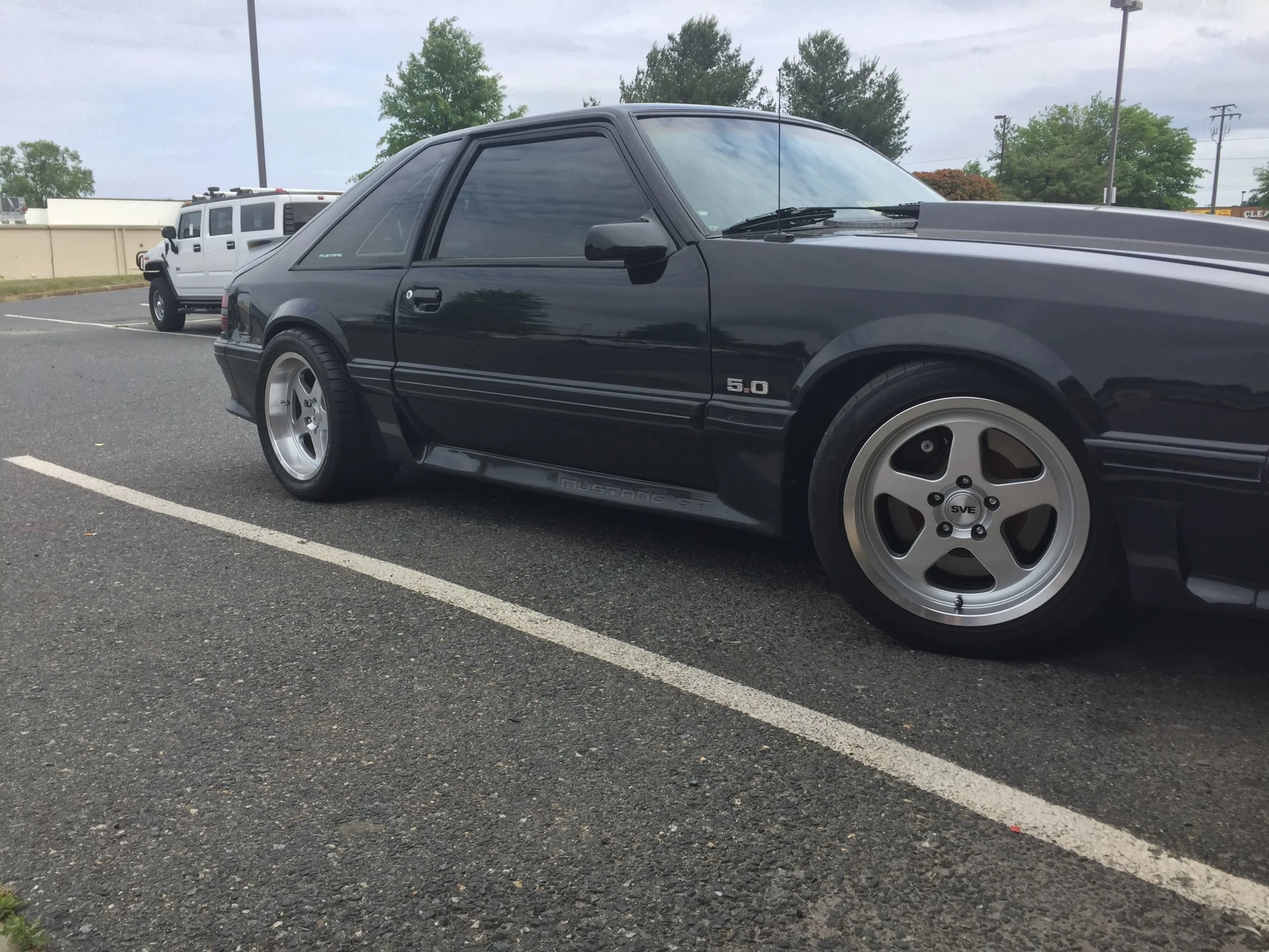

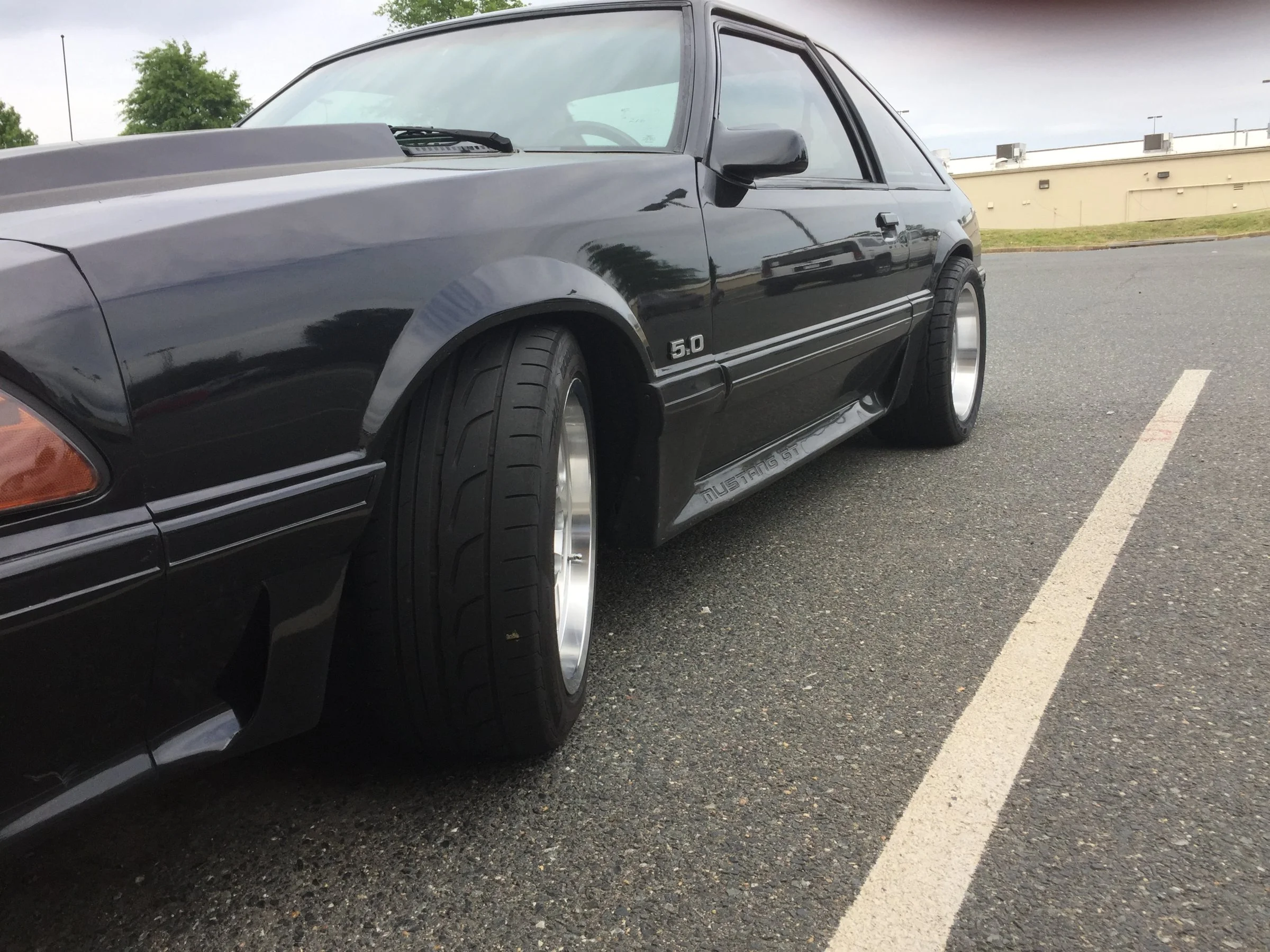

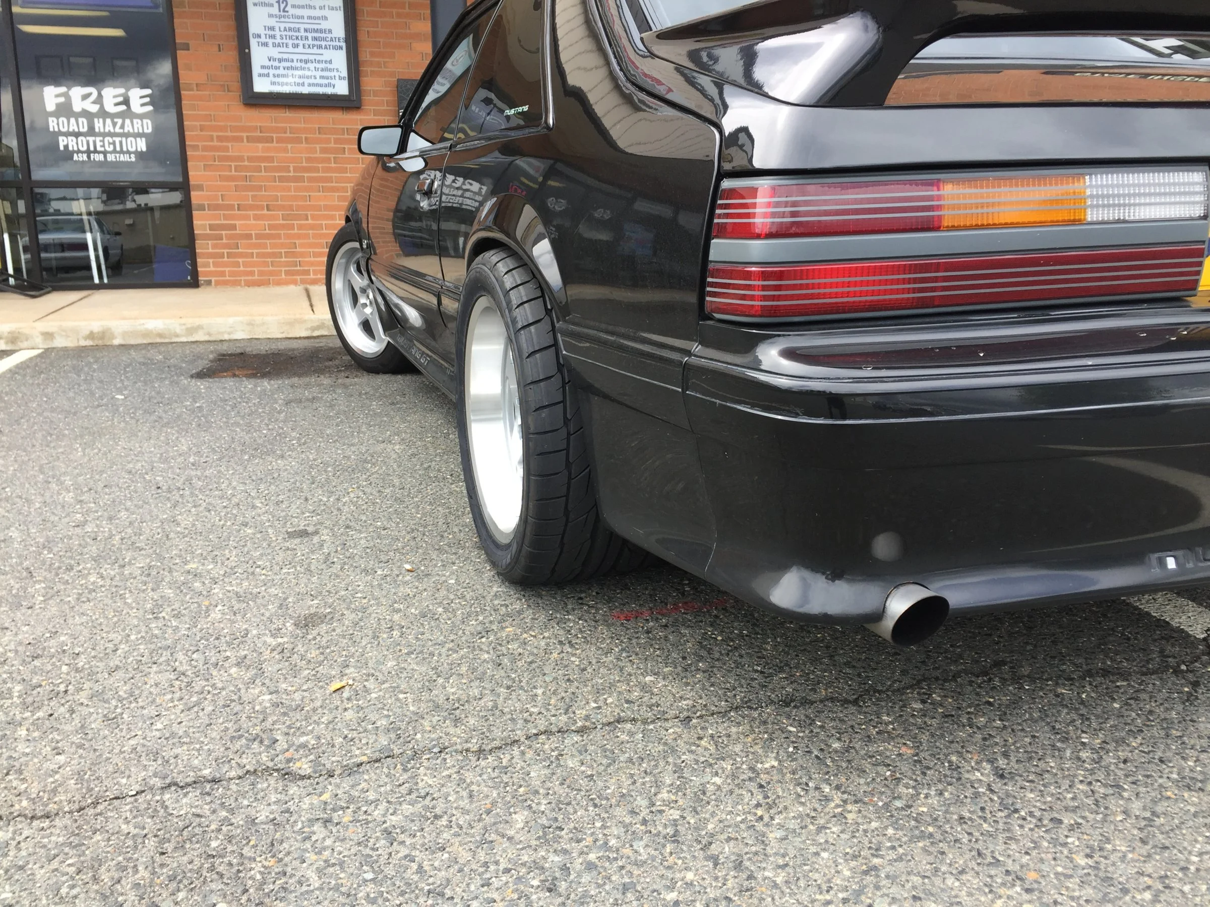

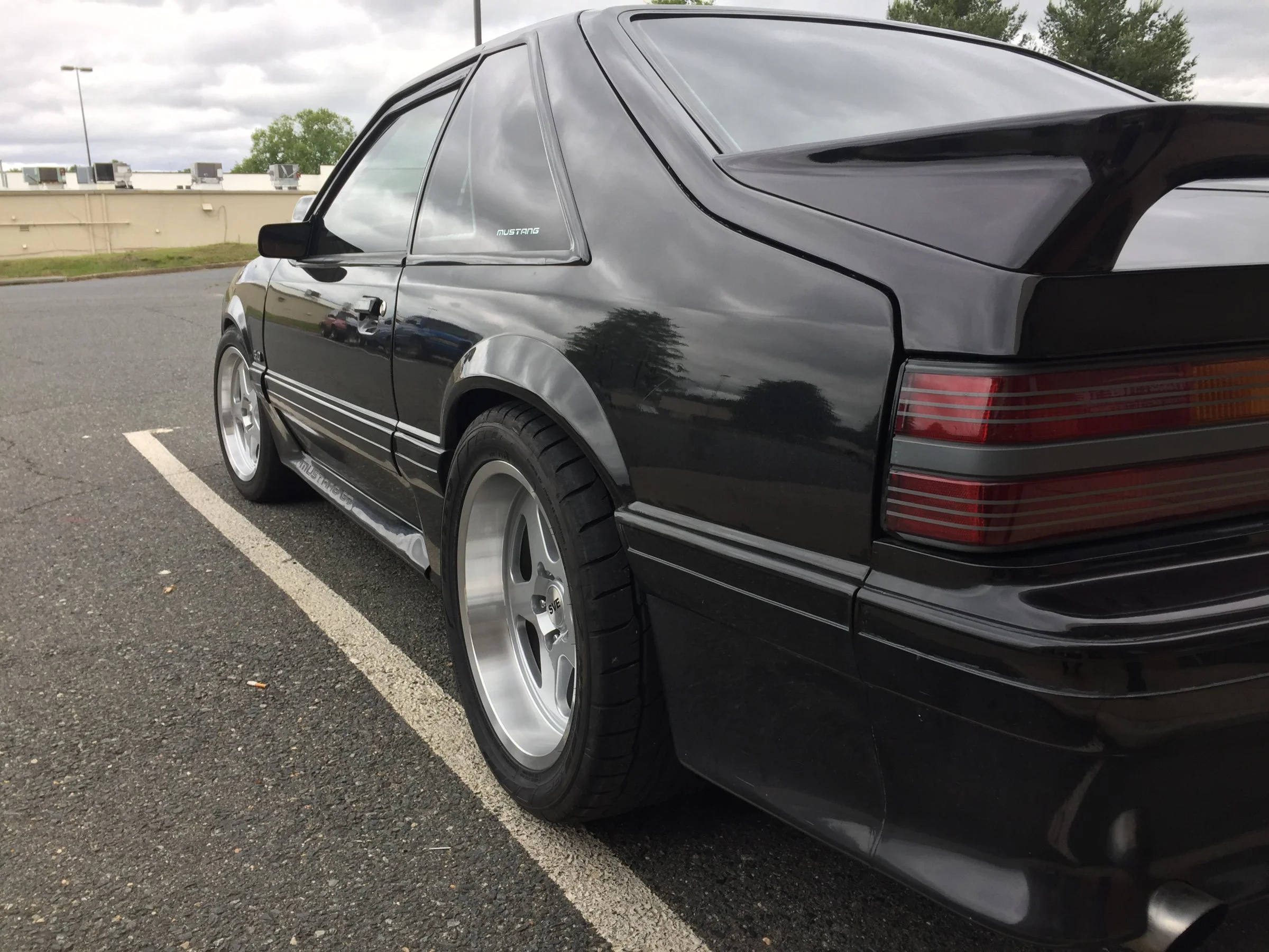

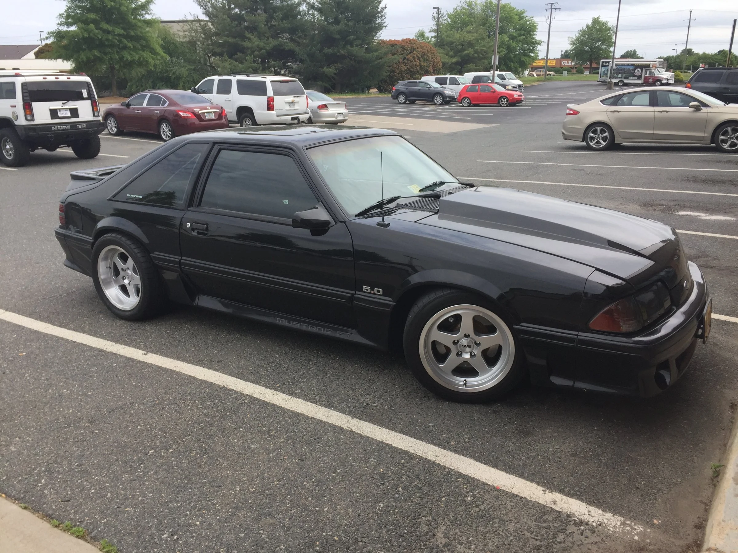

After the SN95 conversion and finally got the SC's mounted.
Still needs a bath tho

Looks great.
Rear wheels seems to protrude a bit much. Are you having issues with it hitting? I assume that's with Sn95 rear axles? Thought about running the north cobra brackets to pull them in 3/4"?
Looks great.
yeah they do. I didnt keep my stock fox length axles either...like a dummy. Also need that bracket to pull them under the car for the result I want. Yes, they are SN95 axles.
I had raceland coil overs on and the rears rubbed ALOT. so I rolled the fenders and it still rubbed.
Replaced the rear coils with eibach Pro springs and rubbing went away, but its not as aesthetically pleasing
Looks great.
I AM right in thinking that the 28spline OEM fox length axles would work with this SN95 rear axle housing and the NORTH brackets to tuck the tires under the car?
Okay. So I cannot stand having the tires stick out this far. Bought the NORTH axle/bracket kit and will install it this weekend.:rock:
BTW-yes, the axle I have came off a 97 GT so this kit should work
